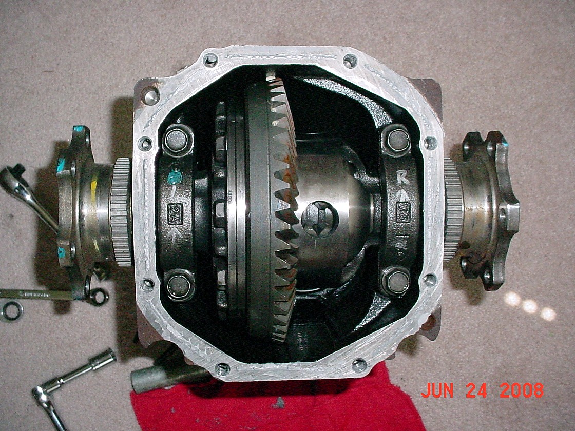

Gotta take the cover off...
If it has an LSD, it'll look like this:
