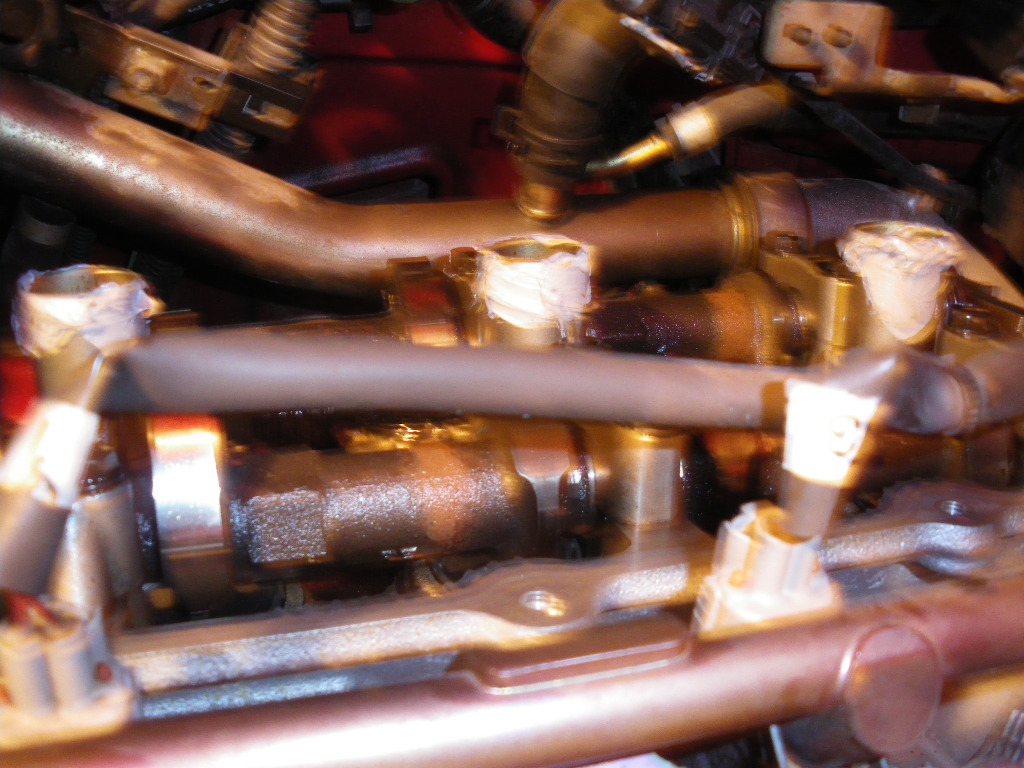

Well being unemployed i couldn't consider 200 each new and if you buy used how due you know it wasnt leaking? I went with liquid (ultra grey by permatex) gasket to reseal tubes and new gasket on cover. I had a 3000gt and that was recommended from dealer to seal oil pan. Its very thick and sensor safe made for high temp.due some research i found articles here. I only have 1000 miles since fix and seems good no leaks. I'm even boosted. Be very careful with the plastic cover they are fragile. good luck

Default attempt at valve cover repair
100,000 miles later-imgp0133.jpg You can see the grey on (1st photo) around the tubes..I also used a small dab in corner of valve cover with new gasket (2nd photo).work quickley and be careful.Do each valve cover 1 at a time.100,000 miles later-imgp0135.jpg

Dont for get the longer you let this cure for the better chance it will take i waited 2 days before i started it up
