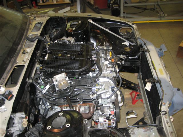

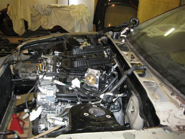

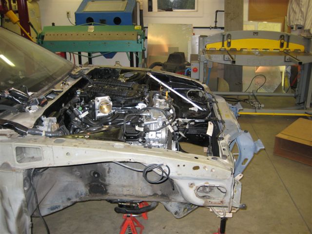

ah, and here are some more pictures with the intake manifold on. the fact that the throttle bodies are on the side seems to allow you to place the engine a little closer to the firewall... actually the tightest clearance against the firewall are some water lines, as opposed to a vq35de, where the little u-turn after the throttle body is a clearance concern.
The only thing my car is missing electronics wise is front wheelspeed sensors, other than that it will have identical wiring, unless i have to do something because the lights are different... havent even thought about that one yet

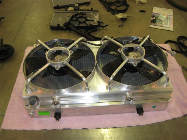

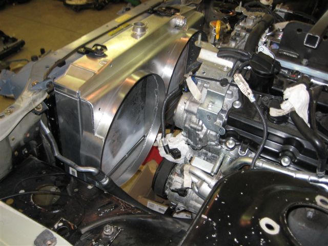

anyways, i got my radiator from griffin. cost about 500 bucks, but its rated to 675 horsepower.
the thing looks pretty impressive. all welded togeather by hand too.

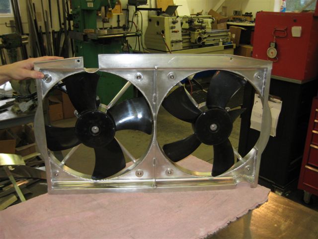

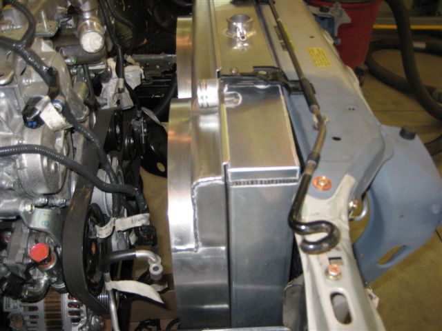

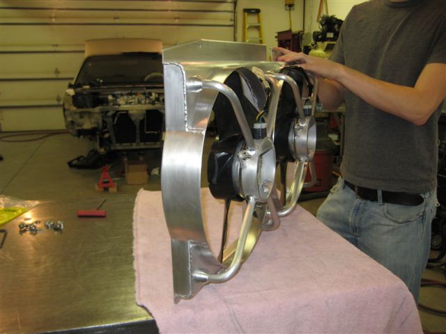

Anyways, I have quite an appreciation for welding aluminum these days.... i spent a LONG freakin' time building a custom aluminum radiator shroud that uses the 350z fans and fits my custom radiator. probably 4 days to do this... longer than it took to get the engine in... a lot of the welding was done by my dad, but i did get to do a bit.
Anyways, it took forever, but Im super pleased with the results.

the exhaust manifolds will need to be cut and re-welded to fit.
the cats will work just fine... they hang a bit below the frame rails, but so does the transmission...
