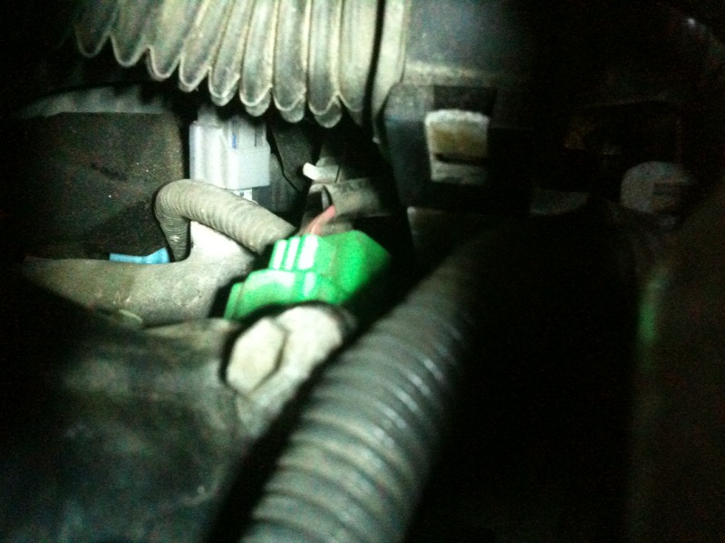

Hello, guys.
Im trying to replacing my knock sensor and harness, but i couldnt get the harness out.
You will see the skyblue clip under and harness goes down to clip.
I cannot reach these!!
Help plz!!
How did you guys worked?

To get to the knock sensor you have to take off the upper and lower plenum, fuel rails (leave the injectors in the rails if posssible) and the intake. The sendor is right on top of the block in the center with the clip facing to the rear. Its almost impossible to get to without removing the other components. You can try to get to the connection after taking off the upper and lower plenum, but I not sure the awkward angle will give you the proper leverage to remove the clip.
yes! I took the all the intake planum and fuel injector.
I can unplug the clip that attached to knock sensor, but it is gard to unclip the other side.
Any suggestion?

If you've gone that far already the intake is a small step further to go and you will have full access to the sensor and connection. I think its only six bolts to get the intake off, just another 5 minutes.
Are you speaking of the side that is clipped to the harness? Or to the sensor? I know there is a small extension piece that connects the sensor and the harness. Mine melted on the harness side and I had to cut it off and fab up a new connection.

Im having trouble with taking out the cable runs out the back of the block.
Any tool suggestion?

I had the same issue; I removed the intake and lower collector, but the back end of the harness is clipped in a tight area and at an awkward area that makes removing it difficult. I think I was finally able to unclip it by standing on the drivers side with a long set of curved needle nose pliers....and LOTS of patience.
Yes, I am also just found the way to get the knock sensor out by standing drive side.
HOWEVER, how did you put your tool in it, I guess that as you said LOTS patience for this job.
Do you know where the clip is toward? (to the wheel?)

Alright, I just uncliped!!
However, the skyblue clip of old harness stucked!! somehow
Do I just pull it out?
Where does this attacthed with??
thanks

wd-40 might help?
what is skyblue clip attached with? (some metal..)

you have to use a flat head screwdriver pressing that unleash button on the clip then use the other hand and pull it out.

I already disconnected clip, and just couldn't take the old clip out.
I felt the metal that connected to the clip, it feels like rust.
Thats why Iam trying to use the wd-40.

stucked!
cannot get it out

It looks like you got the connection undone. I'm not sure what you are saying is stuck? You just have to work the connector out from the harness a bit to get it up top. Now I remember why I unloomed my entire engine harness.
as pic, I already disconnected the connector and just need to take the clip out of way.
However, the back of clip is stuck with some unknown metal.
