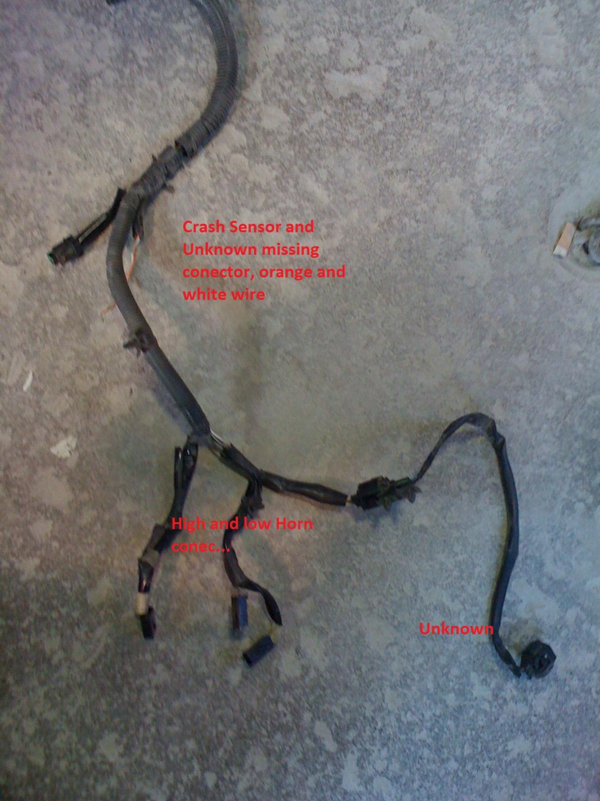

Hey, i need some help from you guys!
i can seem to figure out what wires are which?!
it is the little bundle of wires that breaks off from a loom thats attached to the radiator fan wires, and the bundle has:
-4 wires with connectors ( i know they are the horns high and low)
-1 connector that i AM 90% sure attaches to the front crash zone sensor, i have not fitted it, but the groves in the female connector match the male.
Here is were it gets tricky!
very close to the crash sensor wire, is a white and orange wire, which is missing a connector! what is this wire for?

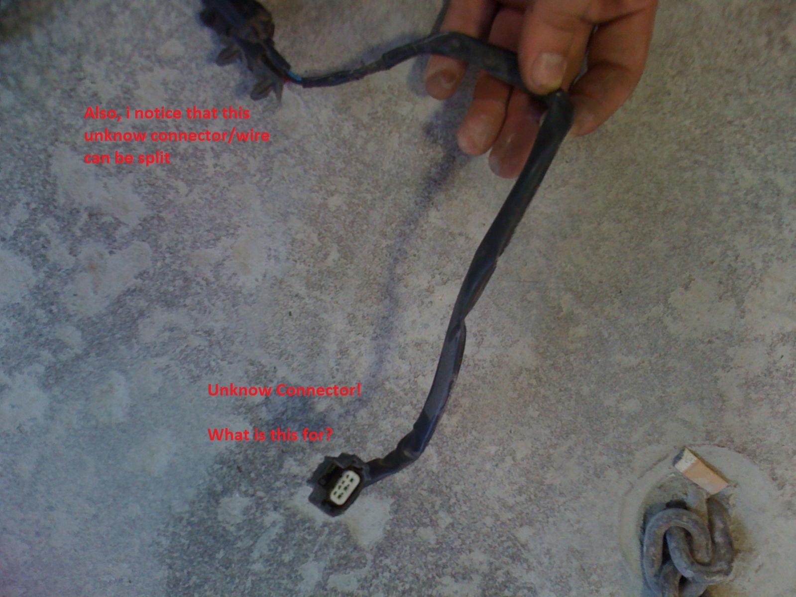

and at the end of that budle, is a female connector with, it seems, 3 wires, what is it for?
thanks for your help!

air temperature sensor

ok firgured it out!, one is a refrigerant pressure sensor, and the other is a ambient (im guessing outside temp sensor)
man that factory service manual is sooooo useful, id hate to be the people who write/draw that up!

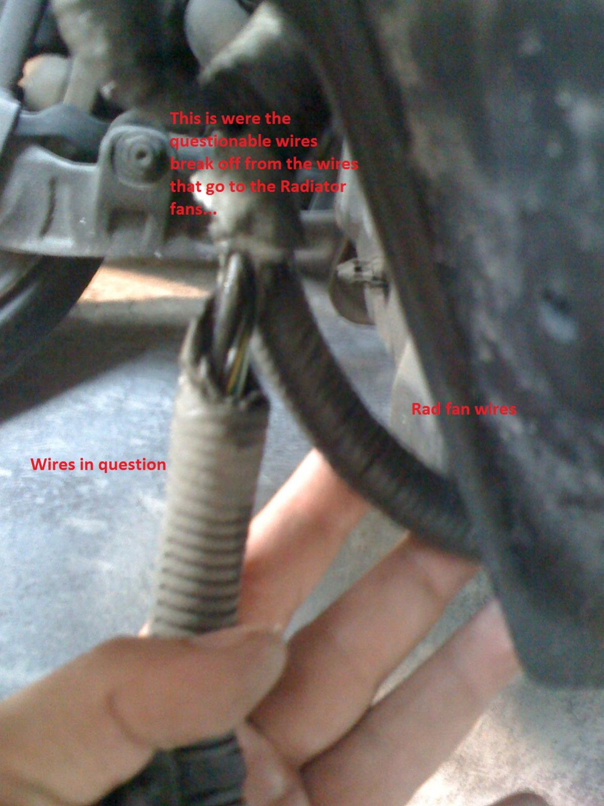

but it doesnt tell me if that harness part can be replaced? or a part number for the bundle of wires (the wirers that were previously in question, and the fan wires), cuz they are pretty chewed up.
anyone have some info on this?

do you know if the bundle of wires, (the rad fan wires and the bundle of wires i was questioning) can be replaced?
like a plug out the crappy wires, and replace bundle with new ones? because these wires are not part of the main engine harness (injectors, crank position sensor, ecu connector) (which i have a spare now)

CLICK HERE for wiring harness.

your subharness that has those wires runs throught underneath the windshield wiper cover, and into the cabin, where it goes through the whole car. i say just reconnect those wires
