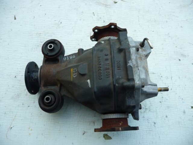

This is a third member for a Z, if you get one just like this picture out of an automatic, it will be a simple and easy swap. 21 bolts to remove it, I can do a 3rd member swap on the garage floor in 1.5 hours.
Thank you very much! You helped me a lot!
