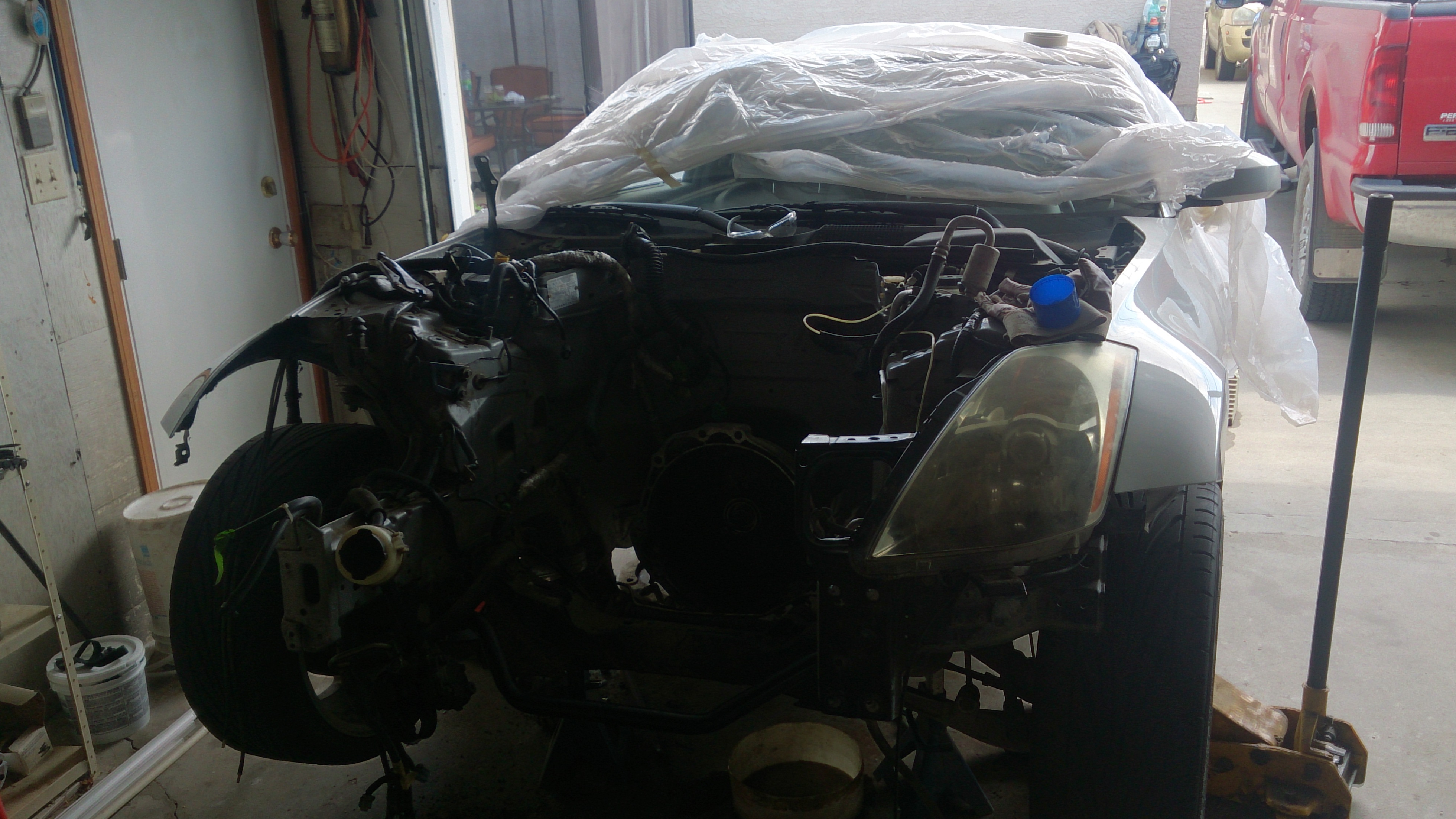

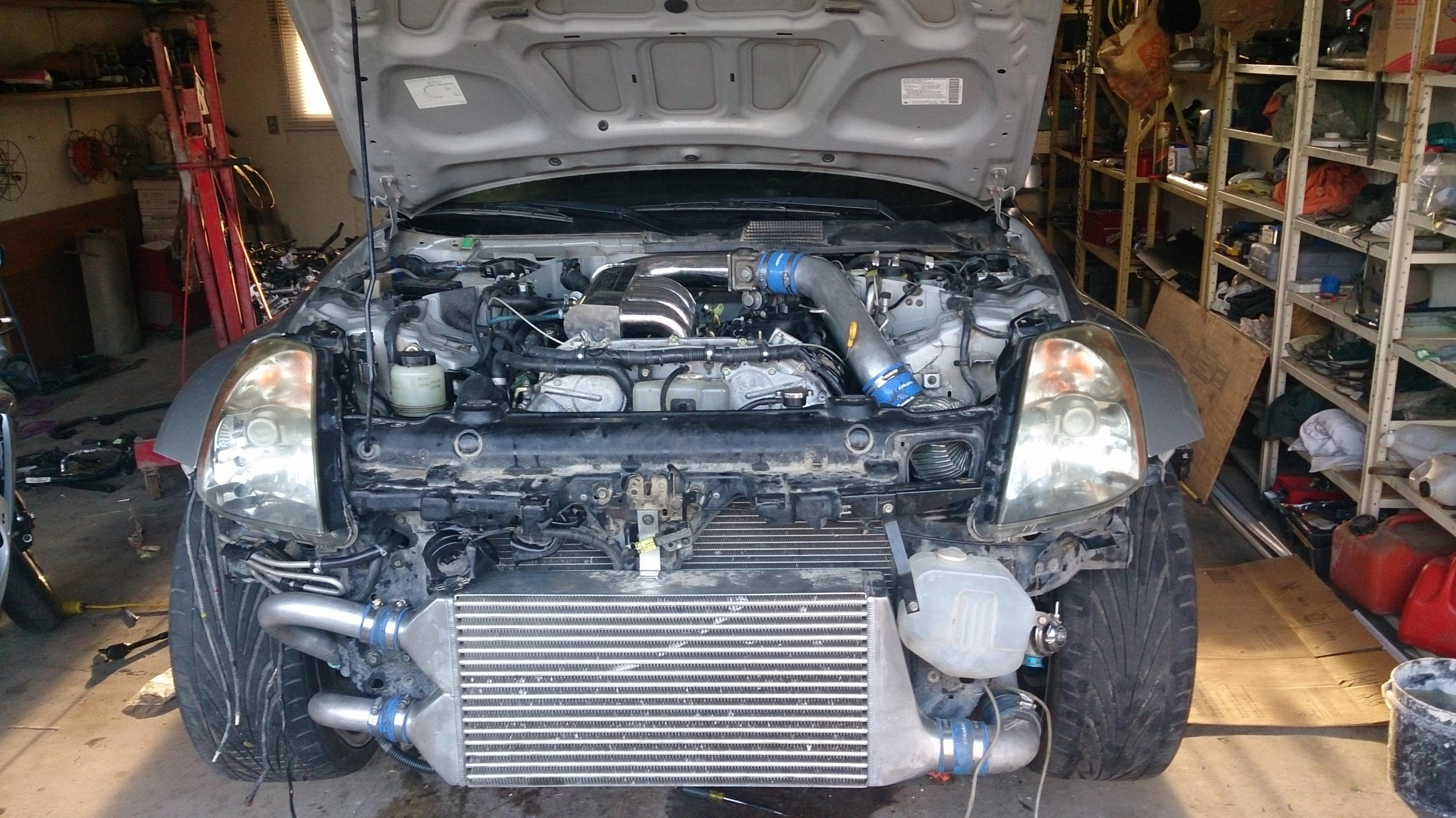

Hey guys, I just wanted to post an update on the project. For now, all the engine work is done. The engine went in great, no issues what so ever. Had to retain 03 engine harness along with injector harness.
If anyone needs an 04-05 harness I got it along with stock injectors and bunch other odds and ends.
Here are some pic of project.
Turbos mounted on new engine
Two of many things found in old engine. Upon closer inspection found a crack in the block.
New heart. Working out the kinks.
Final product.
New motor is 100% stock with 16k miles. My initial plan was to fix and sell but with so much labour I put into her, I'm definitely goanna keep her.
Had I know that initially I would have built the bottom end and crank up the boost. But for now, I'm running 5 psi max and drive it like I own it.
Attached Thumbnails 05 swap into 03-dsc_0207.jpg   05 swap into 03-dsc_0218.jpg   05 swap into 03-dsc_0222.jpg   05 swap into 03-dsc_0232.jpg
