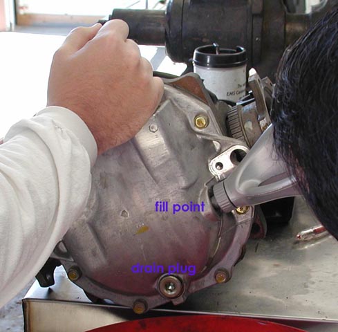

This is a 350Z Track model diff about to go into a G35 Sedan (the 350Z got a NISMO limited slip). You don't have to remove the diff to change the oil... we just had this one out and thought it was a good thing to do.
The Z diff had 13,300 miles and the oil was very used up. And, the magnetic drain plug had metal shavings all over it. In the pic, Don in adding Mobil 1 75wt gear oil to the diff.
When it's on the car, you want to lift the front a little (to help drain all the oil). The oil wil drain forever, so at some point you just call it done and put the plug back in. Clean the metal shavings off the drain plug befre you put it back in. Lower the front of the car. Then open the plug on the side and pour the oil in... up to the level of the filler plug. Some people use a hose to help direct the oil into the filler.

Thanks for the pic... So basically, you know that it's full when oil starts pouring back out of the filler opening?

You don't need to remove the differential as the pic shows. They had it out to install a LSD. You drain it out the bottom and then plug it back up then take the upper plug out and use a hose at connected to the fluid bottle and squeeze/pour it in. When you can stick your finger in the hole and feel fluid on the bottom of your finger, you know you are successful and also the project is over. You can safely plug the hole.

350ed: Yes the fill plug is on the side of the tranny and the diff. It is located towards the end. Look at the pic above of the diff and you will see the fill point.
