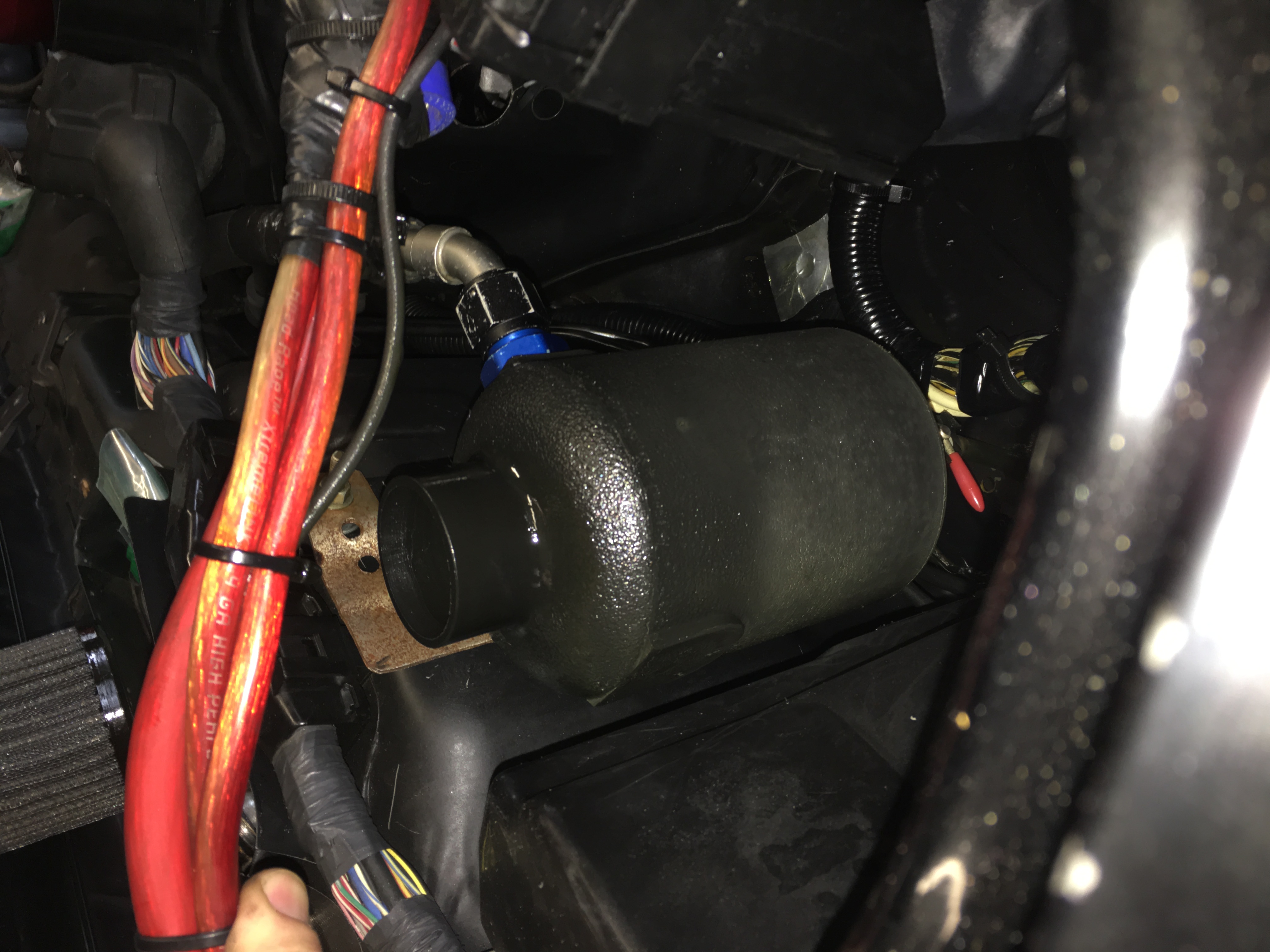

How large of a catch can are we talkin here... Add some pictures, so we don't have to keep fishing for information to help you
[img]webkit-fake-url://5fab8ee4-8a64-4623-ac09-aaba60fcaa3d/imagejpeg[/img]
That's the c.c.? I see a small filter off to the side. IDK, maybe I'm missing something here but it looks to me like there's one hose going to it and that's it?
Put it all back to stock, delete the c.c.. Hose to intake pipe from valve cover on driver side and hose from pcv valve to the lower collector on passenger side and see what happens.
The burning of some oil might not be associated with ring seal. I think that shitty c.c. is getting filled up and the overflows getting dumped into the plenum.

That's a vented catch can with the Breather filter removed no? Nothing wrong with that if that's the case
Nothing wrong with that assuming there's another hose hidden somewhere. All I see is one hose.

I have one line coming from my PCV valve down below the engine. A vented catch can is the same concept except it catches the stuff coming out which is usually just a few drops a week depending on driving style. Only reason I don't run a vented catch can is I don't want it to ever add any restriction to my PCV system under boost.
If you're boosted and you are running a non-vented catch can there is nowhere for the pressure to go. If you're NA then the plenum will still be creating a vacuum (venturi affect) under WOT so you can run a non-vented one to avoid any crankcase odors from making their way into the cabin to reap the benefits of having a crankcase under vacuum (less foaming, less windage, less oil being burned through the rings, less likelihood of oil leaks from main seals etc)

I've never seen a c.c. with one hose, not on a vq at least. A line, assuming you mean hose, traveling from the pcv down below your engine would make it pretty difficult for the crank case to ventilate, no?
No vacuum at wot on this here n/a vq.
Guys tend to vent to the atmosphere when fi'd because they end up with oil in their pipes. If it was necessary to vent w/fi then there would be a lot of pricey german and jap. imports smelling like lawn mowers.
I'd dump that c.c., put it back to oem then see if anything changes for the better. If not, the guy you bought the car from lied. That's the engine he boosted and busted.

The hose I run is short and causes much less restriction than any vented catch can would. I have to side against going back to OEM, because the oil will be burned at an unknown rate without the catch can to monitor how much is being displaced.
Quite frankly (my apologies). You're not at a full understanding of the whole system, or what the venturi effect is/does. Please let me know if you think I'm incorrect here, but here's what's going on:
At WOT your crankcase will still be under vacuum due to the venturi effect occurring in the lower plenum. I agree, your plenum is not under vacuum. The gold colored baffle plate on your lower plenum causes a vacuum to be drawn when air rushes by it. Even though your plenum is not under vacuum, the section below the gold baffle plate is.
Similar to how a non gravity-fed airbrush works. Also why a car sounds like a helicopter if just one window is open in the back; the window pulls a vacuum on the cabin, which then collapses before being evacuated again. This happens a few times per second which is the sound we hear.
The oil in the FI guys pipes is due to crankcase pressure blowing out their turbo seals. OEM manufacturers vent their PCV systems pre-turbo and have a check valve. This is what people miss when they have their turbo seals blow out on our cars. They only do the check valve on their brake booster but forget to vent the PCV system; or don't know any better.
When a OEM FI car is under vacuum the PCV flow is: crankcase>intake manifold (like ours).
When their car is under boost the PCV flow is: crankcase>pre-turbo>intake manifold
I think you're right about your last statement involving that engine being busted though. It only makes sense unfortunately.
