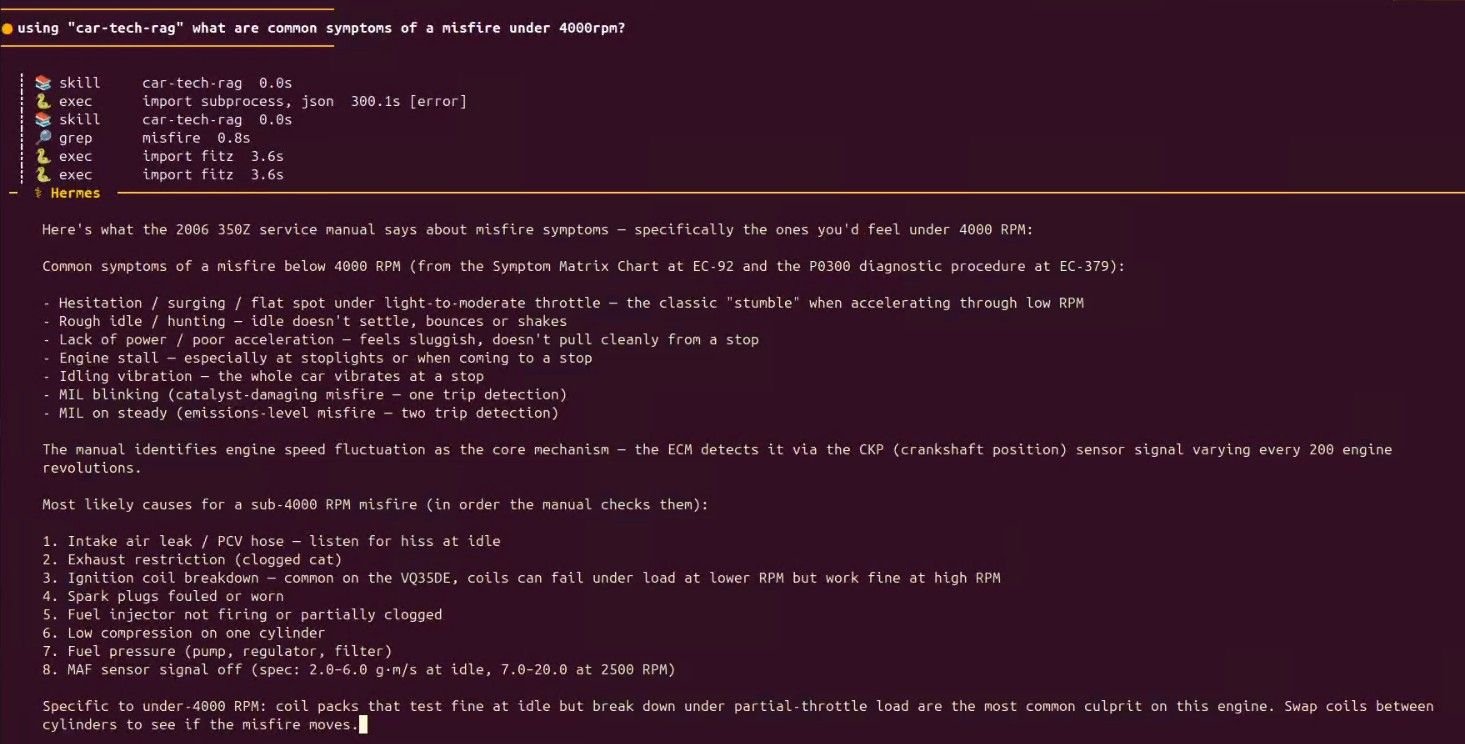

A colleague of mine and I are playing around with AI training. We're using "rag" to ingest data from existing documentation. I trained the AI on the entire "2006 350Z factory service manual" so I can quickly make queries for things like wiring diagrams, torque settings, etc. The LLM portion of the model is connected to the cloud, but everything is running off an Nvidia DGX Spark (blackwell GPU in the home). Here's what it had to say...
I know it's not ground breaking information, but it's still pretty cool how it compiles and presents the data.
