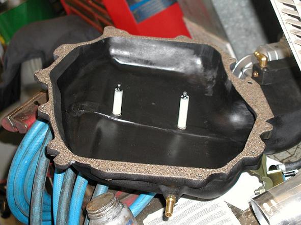

Man, the same thing happened to me yesterday! They sent me the version 1. Check the holes in which the flushhead screws and spacers you are missing. See if the little cork gasket is 1/2 inch. If it is, you have Version 1. We called up Kinetix and Rob over there was very helpful and agreed to overnight us a version 2/3 or whatever they are now. Anyways, since we already had my plenum off and we aren't sure if it'll come in today, here's what we did.
We went to the hardware store and looked for some M6 allthread, but had no luck. So, we ended up buyign some nylon spacer deals and some M6 screws, and washers, and made our own spacers. If you can find some M6 allthread, you'll be in luck. I think the front one has to be 1 5/8 inch, and the rear has to be 2 1/8. Call up kinetix for the exact numbers, but here's a pic of what we did for a TEMPORARY solution.

M6 = size of the bolt (metric), and allthread is like a screw w/o a top-- it's a bar completely threaded. It's a good temproary solution.
