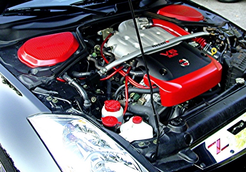

Thought I would share pics of painting engine bay....

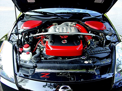

Another

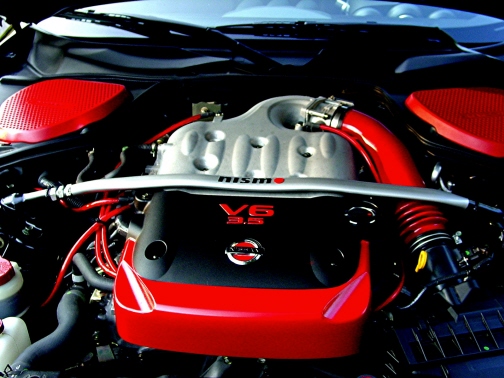

One more

It looks great!!
Did you do it yourself and how long did it take?

It took me about 3 hours. Most of the time spent on taping engine cover.

KRYLON (InFusion). It is a paint made for plastic and rubber. Paint is flexible, and will not crack. No problem handeling engine bay heat.
Total cost = $9.50

Yes it is spray paint.
I put two coats on.
Taping the engine cover took about an hour or so.

Yes, as well as the Brake and Battery covers.

I have had my paint on for over 6 weeks.
Probably 2,000 miles or so.
There has been absolutly no discoloration.
The pictures I posted are from today 8/17.
I don't think any of the surfaces I painted get close to 120 degrees.

All of the pieces that I painted can be touched at any time, even with engine running. At best they feel warm. Not hot.
The engine cover does not get hot, warm to the touch. Definately not anywhere close to 120 degrees.
I have the chrome Nismo oil filler cap. That does get hot to the touch.
Hope this helps.
