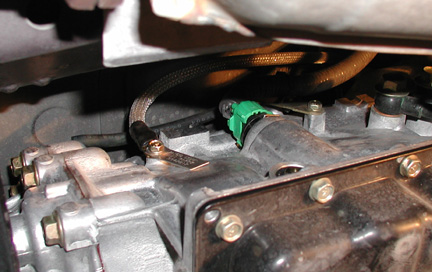

Hi. I have installed each of the other 6 wires in the kit, but now i am stuck on the transmission ground wire (7th wire). I know that it connects to the passenger side plenum connection, but im not sure where exactly.. Does anyone have a picture of this connection? That is my main request.. Also if anyone has a good shot of the lower transmission connection that would be great too.. This 7th wire is annoying =/..

Yup, the 7th wire was a Pain in My A$$! lol but I finally found where it goes, took about 15 mins, because I was on my back, underneath the car. Could only use one hand to hold the wire in place while at the same time, putting the bolt over it and TRYING to tighten it by hand.
After you connect it to the passenger side of the plenum, just run it straight Back and Down as far as possible. Get underneath and find it, and youll see where it's supposed to go..Its a bolt right by a bracket on the tranny, right in the general direction the wire is going...Sorry, this is hard to explain without pics lol. Good luck

Drop the wire down the passenger side of the transmission and you should see one or two locations where you can bolt it to the transmission housing. Be sure and tiewrap it so it won't touch the exhaust.
Hopefully there are multiple places to bolt it up lol..That isnt where I bolted mine..My 7th stretched and sat right at the bolt I mounted it to. perfectly..wasnt necessary, in my case, to tie it to anything to avoid the exhaust, because there isnt any "play" in the wire.
