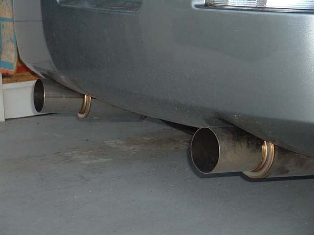

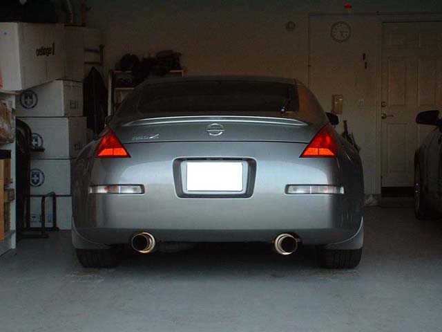

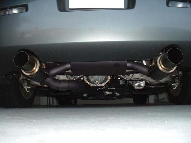

heres a few pics
https://my350z.com/forum/attachment....&postid=696264
https://my350z.com/forum/attachment....&postid=696263
https://my350z.com/forum/attachment....&postid=696261

Wow great info! Is that the same exact exhaust as the one in the link below? Do I see three mufflers in the back...one in the middle, then two stainless canisters? Also compaired to the 30+ other exhaust systems...where does this fall in terms of loudness? Middle to high?

Yea its the same as the one shown in the pic you posted. I guess it would fall in the mid/high category. I can't tell you for sure since i haven't heard the other exhausts. maybe someone else can answer that one.
