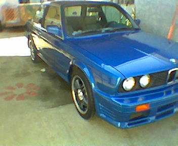

it's a PITA to prep fiberglass specially when there's a lot of pinholes on them. as far as polyurethane (i don't know if i spell it right) but it looks like there's gonna be less prep on them. I'm not an expert on painting just had an experience on it. you have to buy a "bondo for finishing" and sand paper (make sure its wet and dry). i would suggest buy at least 800 grit or higher. it's better to put bondo on any visible pinholes or scratches after that sand it. dont use a machine cause it will scratch your kit. if the kit is flat use a block or something to sand it dont use your finger or hand to sand it. wet sand your kit so that it'll be more smoother and no dust compare to dry sanding. after that prep your kit for priming. they sell those solutions at pepboys which takes any dirt or oil contaminants away from your kit. after that prime it. you need to have a well ventilated garage and some shop light (shop light is for drying the primer since it's really cold outside) moisture can get in between your kit and the primer, paint, clear coat and this will cause the primer to have bubbles. after that inspect again for pinholes. if you think everythings good then paint it. again i'm not an expert just giving you an advise. here's the car that i'm talking about. that's why it's better to have a pro do it rather than DIY they have warranty and you can match the color almost identical to the color of the car.
