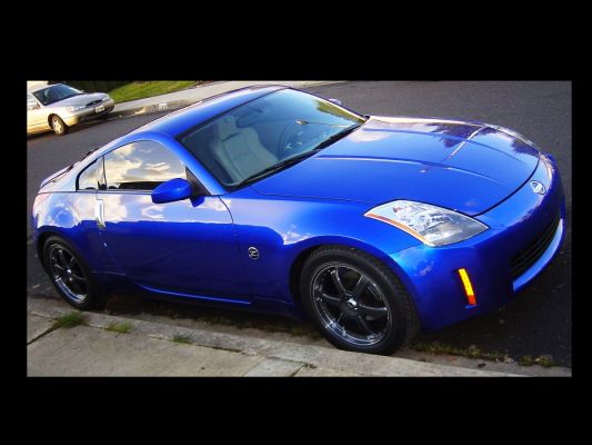

heya guys
Just to let ya know i did do a search for this b4 i am asking but all the results i found either let to dead links or no pictures in the thread or just little boxxes with a x in them
is there a site or instructions for removing the front bumper with detailed directions and pictures???
i want to remove the headlight housings to blacken them!
thanx allot this site is a life saver sometimes!!
