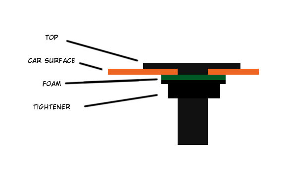

Why did you paint the foam gasket black? Doesn't the foam gasket go underneath the metal? Why paint the edges when it will not be seen?
I'm planning to do this mod soon and am reading up on all the DIY on the forum.
See attached image.
I also took a marker and painted the edge of the foam gasket black.
See attached image.
The foam gasket should go on the outside. It will help prevent water from entering there.
Old Apr 14, 2006 | 06:18 PM
ZlleH's Avatar
ZlleH
Posts: 4,589
From: Ottawa, Canada
But that's what the OEM rubber cover is for, isn't it? You don't remove it...
So if it was good to stop water from coming in originally, why put the foam on top of it, I would think that the OEM rubber on the top with the foam gasket underneath would work much better, right?
I understand what you are saying, but the original post stated to remove the original gasket. My guess is that the original gasket is to tall to get a good flush fit. I would have to look at mine to get a better idea. I plan on doing this over the weekend.
Old Apr 14, 2006 | 08:32 PM
Paul350Z's Avatar
Paul350Z
Living in 350Z
Joined: Mar 2005
Posts: 4,704
From: Riverside CA
The OEM gasket would have raised the cover up just a bit more than the foam gasket did. Plus I found my OEM gasket was torqued with a big wrinkle in it that might have let rain into the trunk if I ever allowed my car to get wet.
