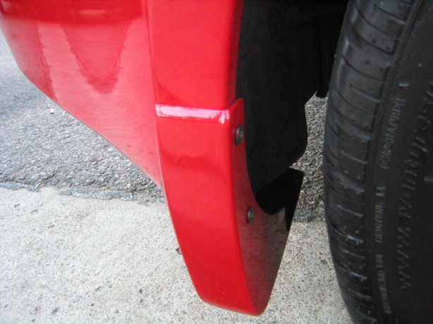

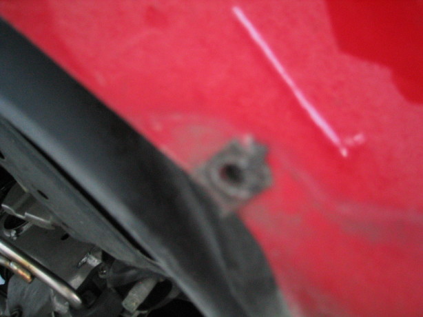

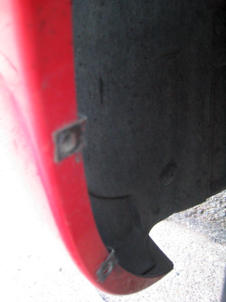

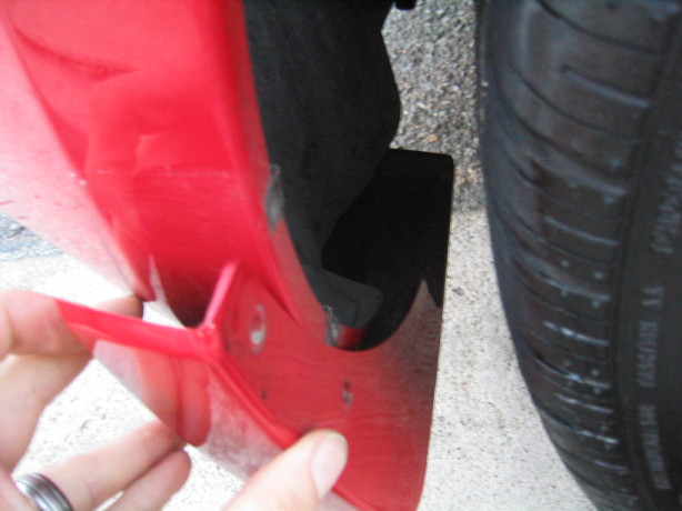

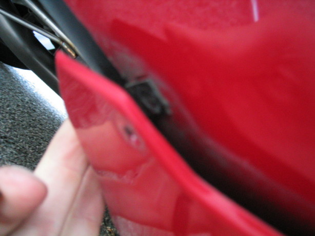

No, 3 of them were pretty scraped up so I just replaced all of them. Im assuming that its the rear one thats messed up? Took some pics. Basically there are 3 holes in the bumper and theres 3 threaded spring clips that lip over the holes. What Im thinking (???) happened is that you lost one or all of these. No biggie unless the holes were ripped open. You can pick them up from a decent harware store or Im pretty sure an automotive store. What am I thinking?!!? A whole new set will come with your splash guards! Heres some pics. Let me know if this sheds some light....
