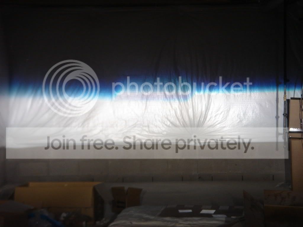

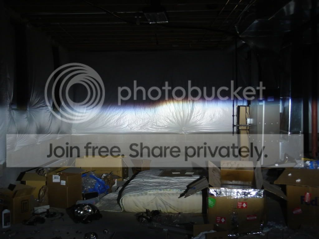

Finished, more pictures tomorrow bc it's raining.
Cutoff at 25ft
Color is a bit off bc of the camera.
Will have road shots later tomorrow.
Low beams
Right lowbeam
Right Foglight
Both Lowbeam foglight
Both High beam on (right side only)
Setup
That's all for now...

Old Mar 28, 2007 | 11:23 PM
jimmyloose's Avatar
jimmyloose
Posts: 1,638
From: Irvine
the G has so much room to work with, the Z headlights honestly have room for one projector and that's it.
On the contrary, studying my headlights lately. I think there's plenty of room for two projectors... IF the signal light was retro'ed to the bottom where high beams are and the high beam gets retro'ed to the signal light, and then a big low beam projector on stock position.

The headlight on the 03-05 Z is definitely large enough to fit multiple projectors, it just will require custom brackets, but that's also necessary for 06 Gs, so not a big deal, I will need to custom fabricate a shroud to make it look stock.
It's LED 194s behind the projectors. I chose this so in the distant future that it does burn out, it will be easy to replace relatively to just soldered LEDs.
As far as the turnsignal, it's just the Lens in a stock turn signal in the 06 with regular turn signal bulbs.

Thats a beautiful cutoff
