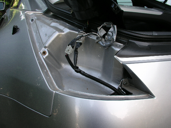

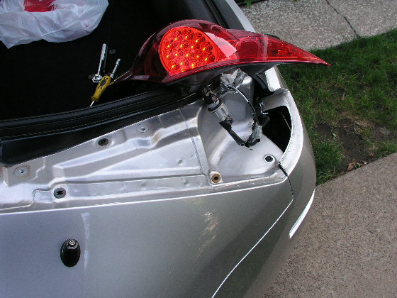

Default led lights mods
Pop the Three screw Cap covers , 12 mm Bolts ? , Carefully pull from body, " Caution !! Do'not break plastic lineup tang in the tailight assembly while removing from the car body !! , Remove the two Led Wire plugins , plug in new lights and real carefully re'assemble ..Done !
Do a search, Their are plenty of writeups and pictures on my350z .com ..

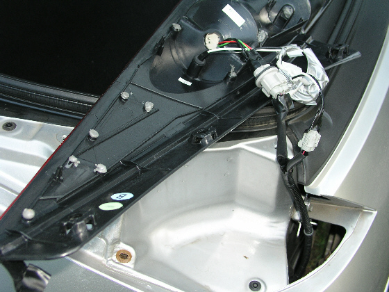

Default Led Mods ..
More pictures ..

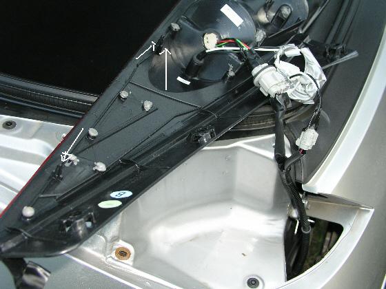

The bolts are 10mm but the rest is all correct. OP, remember to pull the lights from the top end (narrow end) and pull them outwards perpendicular to the car to save the tabs.

Default Led Taillight Mod Lineup Tabs
Plastic Lineup Tangs, Do'not Break ..
