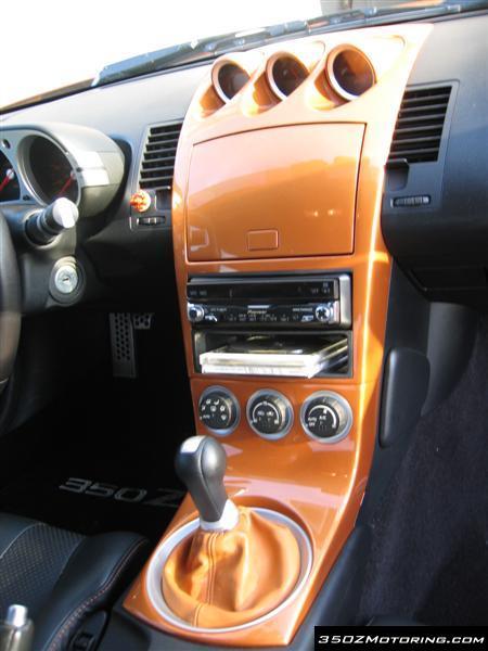

i talked to my body shop guy...and he's wanting to charge me $500 to paint my dash! he says its a HUGE job and nearly impossible to ensure the paint will stick. WTF? can anyone tell me exactly what kind of primer basecoat i would need so i can do this project myself? after i get the dimples filled and sanded i can take it to a shop and have them lay the silver on.
want it to look like this...but in chrome silver
any advice will be helpful. i have my dash ripped apart because he was supposed to start on it today!

LOL, that's my dash in the picture
It was done professionally here by a bodyshop I know
There really is a lot of work to do to make sure it sticks and looks good.
If you're interested in getting it done, PM me
