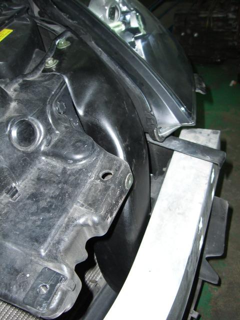

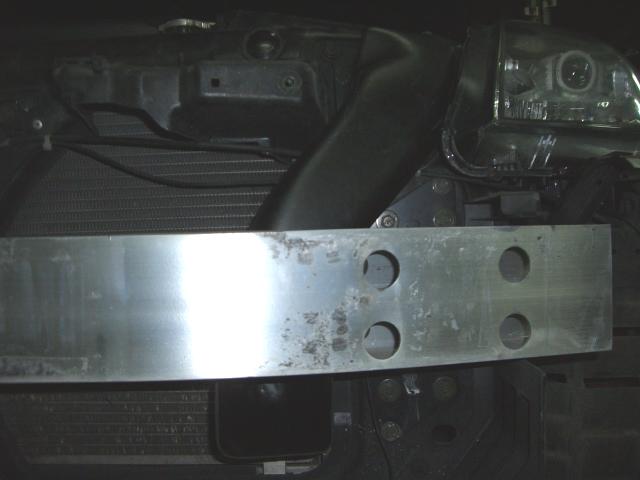

Pretty much just line it up with the air-intake duct. I used some metal screws to bolt it into the bumper support. You will have to cut some of the foam to make it fit.

Drill out the two premarked holes. Set it on the right side of the bumper support. Mark holes with a sharpie. Drill bumper. Apply plastic lock-in clips.
