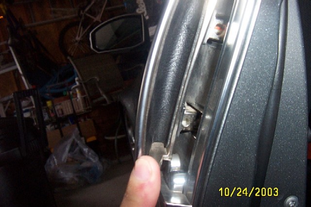

I like both ideas very much but, what does the backside of the door handle look like?
How long before you knock one of the LEDs loose from opening the door all of the time?

Default Door Handles
The door handles that have LED's in them have been covered with a vinyl material so they will not affect the LED's in them as pictured here , as well here is some other areas they are in

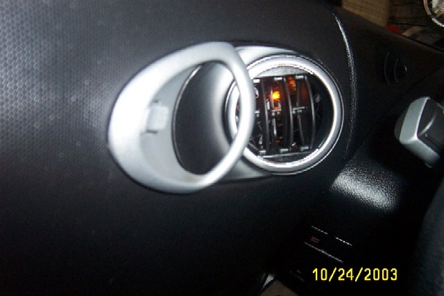

Default LED's Pictures
Here is one that is inside the air vent
