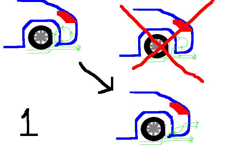

I"m skeptical of the diffuser, heres why
You have a definite amount of air in the space in front of the rear bumper. There is no outlet for this air to currently escape. So there is no option but for this air to circulate within its given boundary, with the outside air sliding along the boundary containing the air. The only resistance you have is the air on air at the boundary opening.
So if you create an outlet for the air to escape, you've now created a flow path through the bumper. Now you have air resistance along the entire inside of the bumper.
air/air resistance < air/bumper resistance. see hastily drawn figure 1.

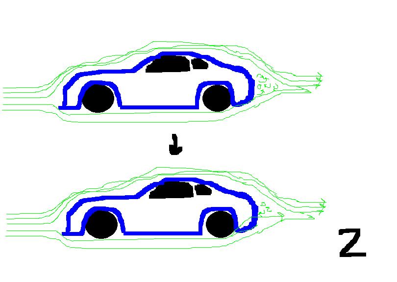

The only way I can see this being beneficial is from the overall aerodynamics of the car and the turbulent low pressure zone behind the car. This may be an effective way of increasing the pressure in that area and lowering the turbulence thereby making you more streamlined. I'm not even sure it would work in this way though.
see hastily drawn figure 2
So if the benefit of the increased pressure offsets the disadvantage of the increased drag, then I would think that you are good.

Wow. Brrcats- thanks for the awesome visuals- I mean that, they're awesome. And robbinsj- that's a good write up on diffusers. Both are very informative and I appreciate the input.
