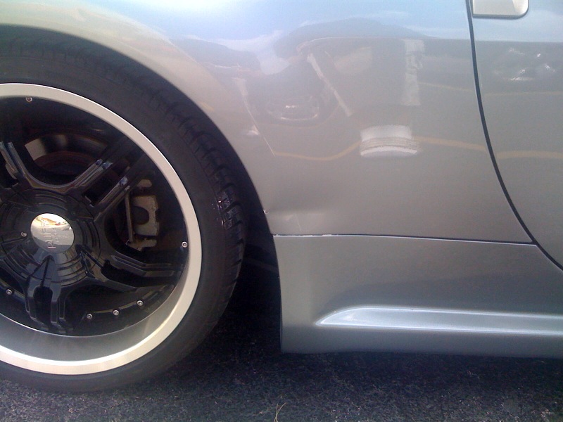

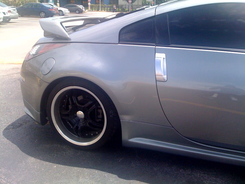

Someone put a dent on my car..... Don't know where, when or why, but god damn it i am soooooooooo pissed.
At least i managed to remove the nasty scratch with some scratch remover my dad had on his truck...
Shops charge me over $300 to remove it and repaint the whole piece, i've been looking for paintless removal but i am not sure if that'll work on the dent because its in the quarter panel... I believe the quarter panel is reinforced with double metal and you cant get behind the dent?
Any of you guys have any experience with paintless dent removal or should i just go with repairing/repainting the quarter panel?

Ugh. sorry to hear that bud but to be honest you cant pdr that... im a body tech and i can tell you thats a good 2 or 3 hr dent for us body techs. not only will you HAVE TO paint the quarter but more than likely the door to, thats if u want the quarter and door colors to match. the dents to close to the door. most shops would paint the door also but its up to you.
Another option is to tell them you want the to "burn it in" which mean they fix the dent them just paint the area around it. not the whole quarter.( this is where they just buff the sand scrathes where they stopped the paint) itll look great.... for abt a yr then where they blended and buffed the edge will come bck. its a cheap way but not the best. i reccomend painting full quarter and blending door and removing handles and the door delt molding and mirror so u have no tape lines

you can check but theres no access to the bck and if you can pdr it, it wont be nice looking at all. check but i seriously doubt they can. especially since that body line is there.

yeah i've been watching videos of pdr nonstop and doing lots of research. you cant get to the back of the quarter panel. I saw lots of glue puller videos/tutorials but im not sure how effective that stuff is. Someone quoted me $100 to pdr it, but im scared it doesnt come out completely and i waste $100 and still end up taking it to the shop lol

lol trust me... they will NOT be able top get that dent out. the way metal stretches especially since its in the body line not to mention its size. get it done right bro. gunna hurt the pocket book a lil but you will def be glad at the outcome. dont cut short cuts with your exterior... you have a nice look, why mess it up?

Exactly. i could do that with a body hammer and a dolly. lol and most stories you hear are not on body lines and are small and have access. yours has neither
