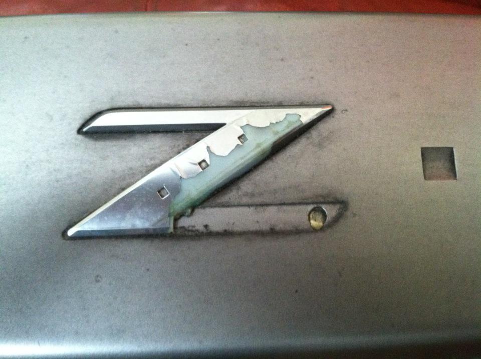

What are every ones solutions to the rear strut bar cover "z" badge solutions to when the metal coating starts coming off? is there somewhere that sells just the z emblem or do you have to buy the whole cover?
I thought I would take the opportunity and make something cool with it instead of buying a new one. I bought a used one that looked in ok shape, but when I got it it had the same problem, so I painted the cover it self the same color as the car when I was painting some pieces on the car and cut out the z part of it where the emblem goes. Then i cut out a piece of plexi glass in the shape of the emblem so it would fit in the hole i cut in the cover it self. Then I sandblasted the plexi glass to give it that mat look and to disperse the light I put behind it better. I bought some small led strips and put them under the cover where the plexi glass z is and wired in to the hatch light, so it glows red every time you open the hatch.

I don't like LED's, but that's just a personal preference. I think it would look a little better if you hid the LED's under the solid portion so the Z would glow evenly instead of seeing the bright spots.
Below is a pic of what I did with mine. I covered it with micro-suede and the fabric laid down into the 'Z' to give it a a subtle, embossed look. The suede w/ orange stitch matches my center armrest door, shift boot and cubby door. The other benefit of the black suede is less glare in the back window compared to the OEM silver panel.
pretty nice! the leds are actually under the panel it self and shine trough plexi glass, they are not that distinct in person vs pictures, it more of a uniform red, i sand blasted the plexiglass to try to disperse the light, but you can still see the individual leds to an extent, I agree it does bother me some. But if I move them further apart the z logo appears a very lite red, almost pink.

Don't like the leds...glows red when you open the hatch??
I guess your preferance.I hate the "silver" used on the strut bar and in other areas of the interior(steering wheel etc.)I've pretty much eliminated with CF.

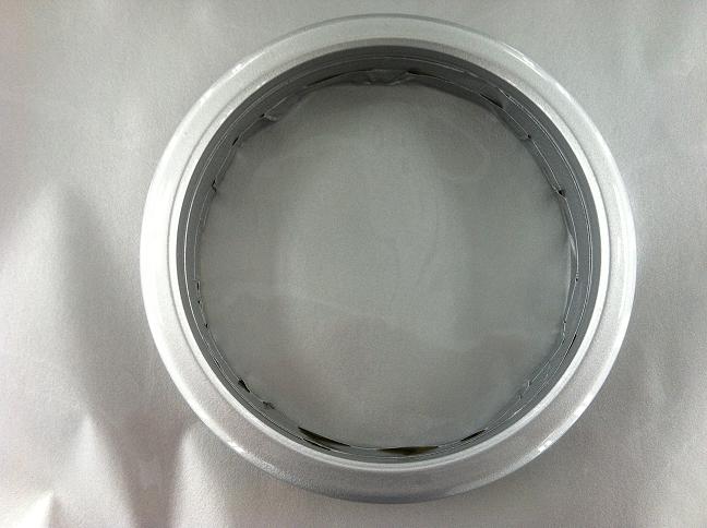

My emblem held strong with 8 years, but finally fell victim to this same issue. When I stripped the emblem it broke into 5 pieces due to the brittle plastic. After some super glue, primer, sanding, and paint this is what I came out with. In the process I also painted the cover, and my shifter bezel because both had several blemishes. I used the factory silver from the 370s and went with Sikkens ABP and Autoclear III for the BC/CC.

looks nice, cant tell that the z was broken at all.
