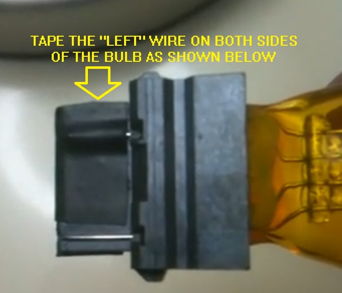

For future reference:
If you change out your front turn signals to LEDs, you MUST tape up part of the connector as shown in the attachment. Otherwise, all your turn signals and all your small lights front and back will light up together regardless of which side you're signaling. And if you insert either of the front LED turn signals in the wrong orientation, the turn signals won't work at all.
Both side A and side B must have the "left" wire taped as shown in the attachment, in addition to inserting the LEDs in the proper orientation for the turn signals to work properly.
Back when I put LEDs in my 03-05 headlights, I didn't run into this issue as the bulb itself is different for the front signals. This is only for those with bi-xenons.
I was able to fix this issue without spending any money and it was a simple (and maybe even common sense for some) fix. Fortunately, I was able to figure this out after searching and stumbling across a thread about troubleshooting a DRL "problem." Forums FTW!

correct.
but don't your LED signals flash fast now since you have no resistors setup for them? or do you have the resistors already?

I already had resistors from when I had LEDs with the older headlights. I did rip them out last night thinking they could somehow be part of the cause, but I will be putting them back in.

I did the same with my front turn signal bulbs too on my 06+ headlights. A lot of threads say cut the wire, but it's less hassle in the future and cleaner this way with electrical tape on the bulb wire.

I am glad I post this video a few year back to help someone on this forum out. Since the video I went the extra step I rip the wire from the bulb where you see the tape I put on both left side. This way no tape is needed.
