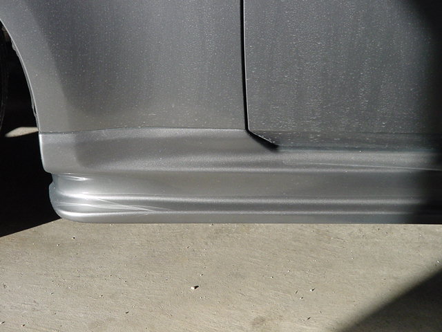

got my side skirts back and my nismo wing. There is a slight mismatch in paint color. I guess there isn't much that can be done other than have them repaint it... I don't think the shop will do it for free since it's kind of the nature of painting right? I guess I could throw a fit and have them do it .
The nismo wing looks pretty damn good just about the right color. I had some bumpers painted and installed at a different shop and it looks perfect!
I didn't go to them cause I felt they wanted way too much to paint the wing and the skirts, close to 1200 dollars. I got the skirts and wing painted for 376, and I've installed the skirts and I'm installing the wing myself.
Is there any type of blending or airbrushing that can be done to have them match better?
Thanks,
Kevin
in the picture it almost looks like chrome silver

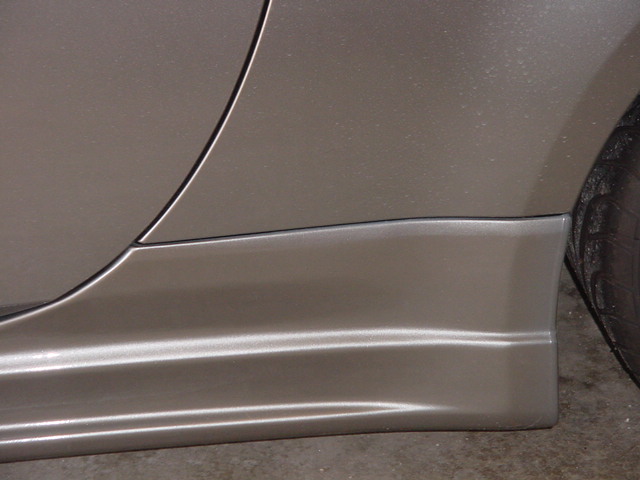

another picture it doesn't look as bad here.

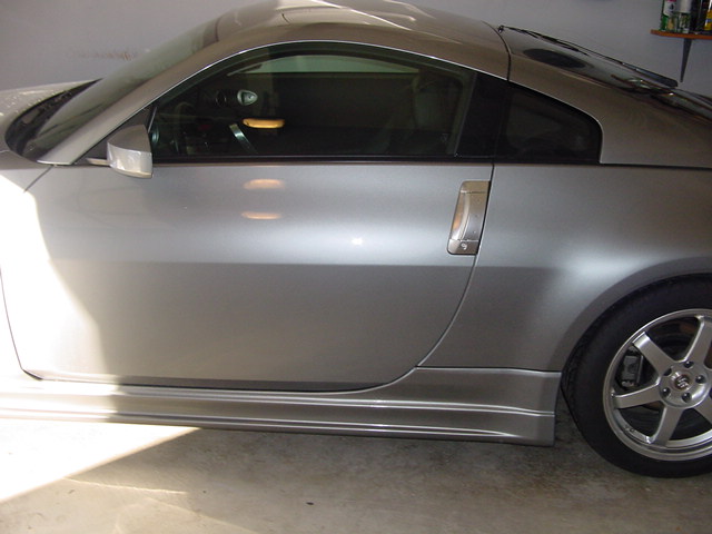

Maybe it just looked really bad in the first picture cause of the lighting..

Bring it back and show them the difference....
Old Jan 19, 2004 | 05:31 PM
ColecatZ's Avatar
ColecatZ
Posts: 1,460
From: Dallas, Tx
I say you paid so you should be happy with the service.
Take it back and have them redo it until you are happy with the match
Old Jan 19, 2004 | 05:45 PM
fdao's Avatar
fdao
Posts: 1,628
From: Hawaii
Unless you like the two-tone look, I would take it back.
Old Jan 19, 2004 | 05:54 PM
EL Diablo's Avatar
EL Diablo
Joined: Oct 2003
Posts: 1,641
From: The Under World
it's hard to tell from the pictures.
from the first one it is noticable.
Take it back. Why not ***** if you
the job wasnt done right. The
Price is a huge difference from
the other place.
you know what they say.
you get what you pay for.

ok im a painter
it will be hard to get a perfect match on bodykit
because you are butt matching the panels
the only way you wont notice it is to blend the color
on to the qtr panel and door and fender
you can go back and tell the shop to respray the
side skirts by adjusting the color now since they
can tell which toner to adjust in the base

plus the piece they painted is fiberglass. It is very hard to match the body of the car perfect. It doesnt look bad at all. Take a pic in the daylight so we can see it.
