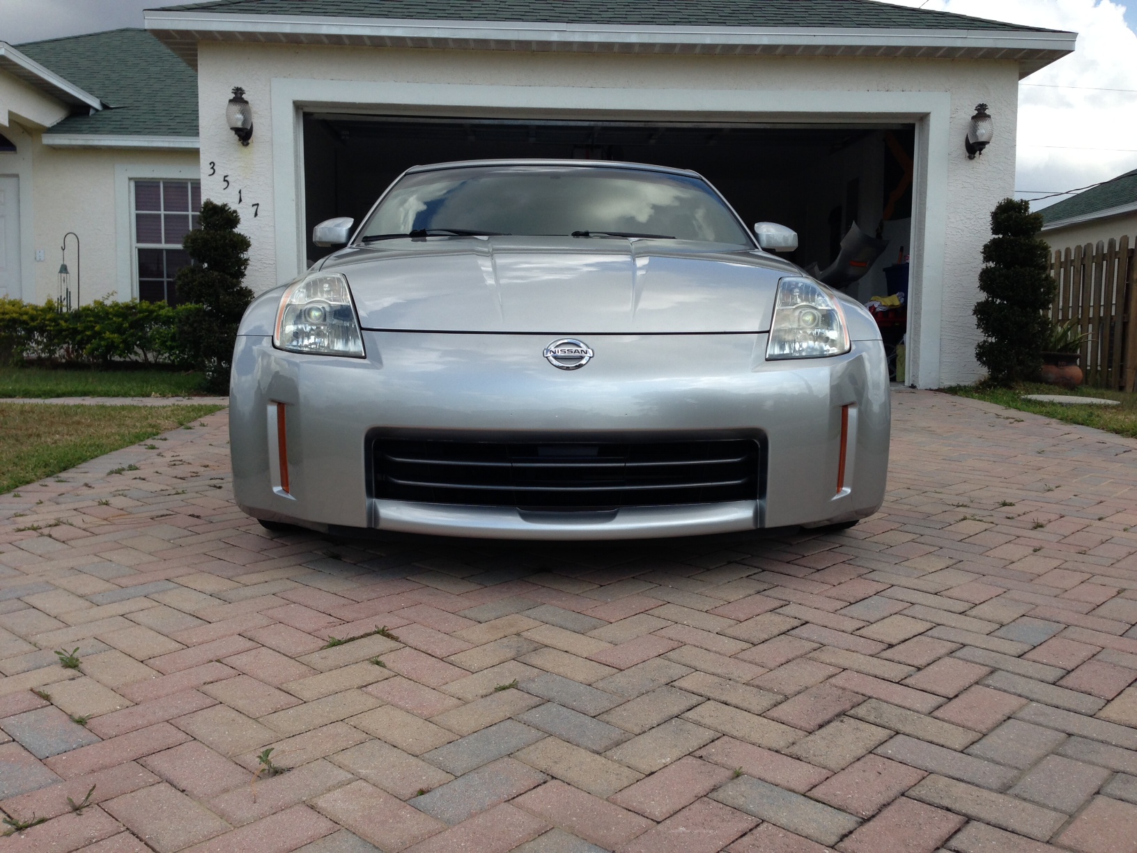

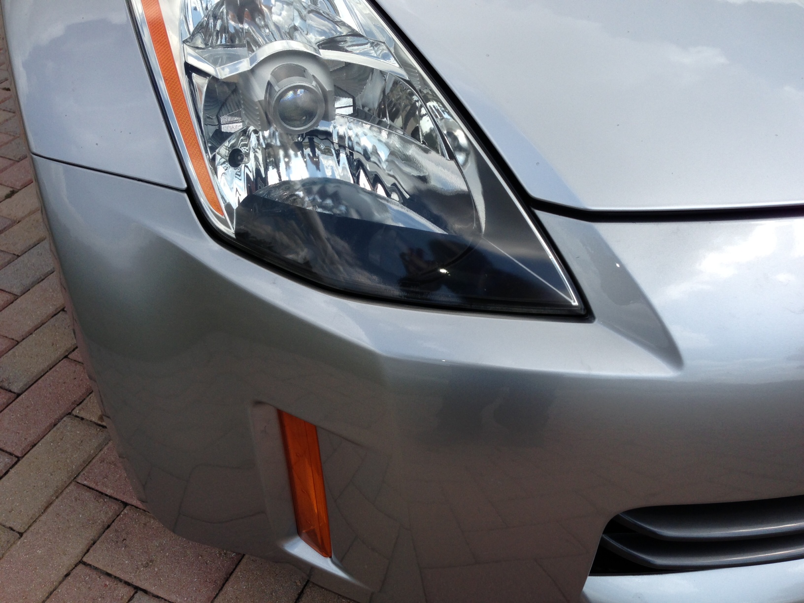

I put my bumper on today and everything went smooth. AdvanZ33's information is correct, there is no need to buy the 06 fender liners and the gap by the corner of the lights is VERY min. Here is a couple pics for you guys. Thanks for the help.

^ Quick question for you.. for some reason, my passenger side of the bumper was a little bit more of a pain than the driver side. Did you have any issues there?
Old Mar 26, 2013 | 04:54 PM
smokeneyz02's Avatar
smokeneyz02
Posts: 7
No, I did not have any issues at all. I did keep some inward pressure on the corners of the bumper while screwing in the 10mm bolts to help minimize the small gap by the corner of the headlight, but that was about all.

As you can see from the bottom left hand corner of the photo there is a slight fender gap if you don't upgrade to the 06+ fenders.
Not really a big deal though
