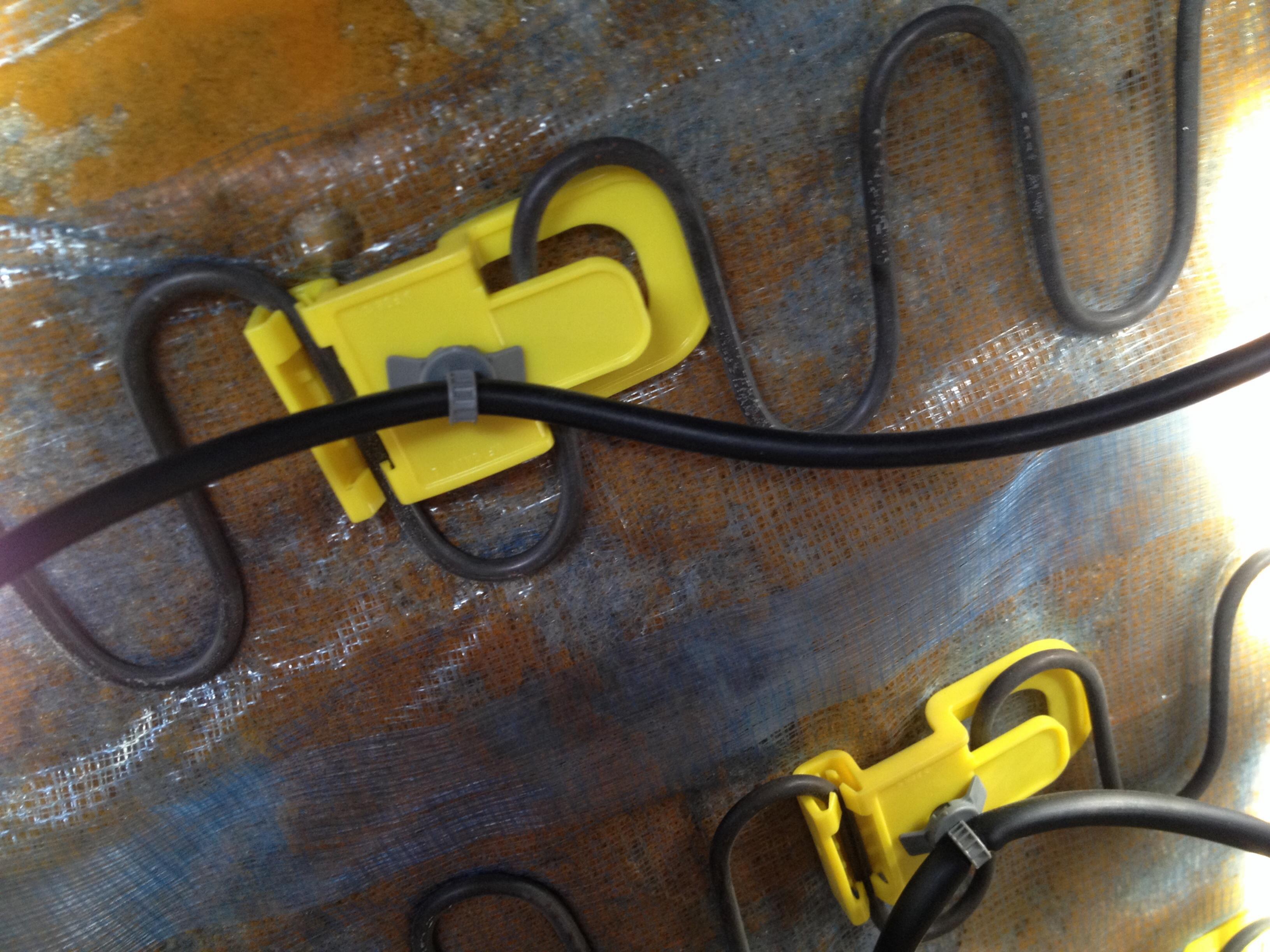

Decided to try and tackle my seat covers today. So far it's been okay except I hit a bump in the road. I can't really figure out how to remove the clips under the seat cushion. Can anyone who's done this before give me some input? I keep trying to move the tabs off the metal and pulling it but it's not working...(Also, is it okay if my seat cushion is this weird yellow color? lol)

Push the little tabs in on the left side and then lift it and slide the other side out. Use 2 flat nose screwdrivers or a chisel and lift the yellow tab while holding the tabs open.

I kept trying to push the tabs out of the way, just couldn't move them all out of the way at the same time. I'll try this on thursday and hopefully I can get another set of hands to help me. Thanks.

It looks as if you may only need to get one side of the clips pushed in. That may give you enough space to bring the wire through.

Turns out I just wasn't pushing down hard enough. I used a flat head to push the left side off the wire and then just pushed back on the yellow piece and it came off. Now onto the hog rings! lol.
