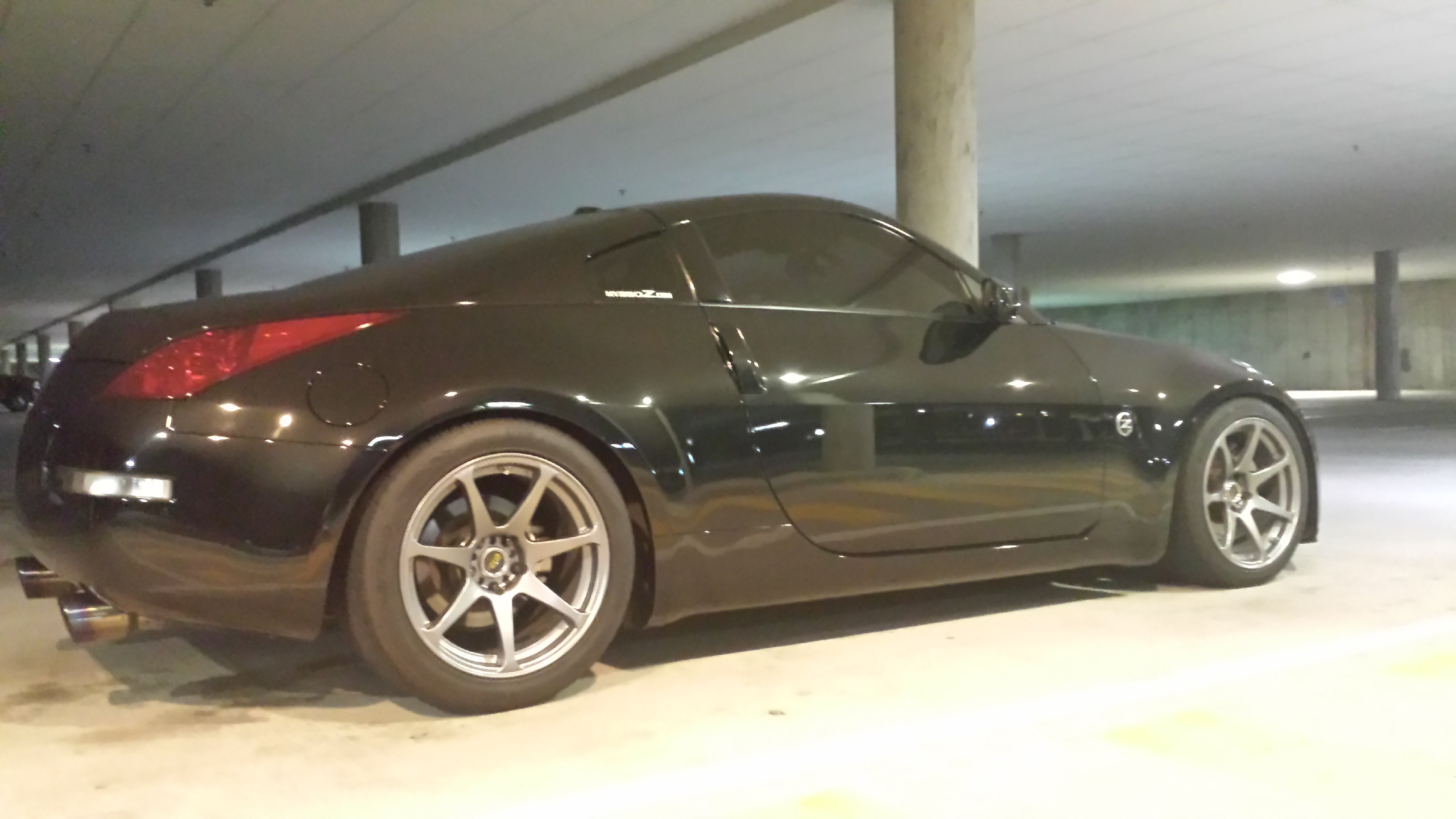

I own a gloss black Z and to be honest, if I had to do it over again I would have gotten a different color. Black is super hard to keep clean and imperfections show way more on a black car than any other. Also, you can't add black accents to your car like you can other colors because it's already black. If I were to wrap my Z I'd wrap it in a cool color or something that isn't black lol Also, one thing to think about is that any imperfections will show through the wrap. It obviously won't look as bad but it will show through because it's razor thin. Good luck nonetheless but I would either have it painted or wrap it in a cool color.

Before you decide on gloss black wrap, keep in mind that it does not reflect like gloss black paint. It swirls and scratches easier. It also has an orange peel effect on the surface. Quality black paint is almost mirror like.

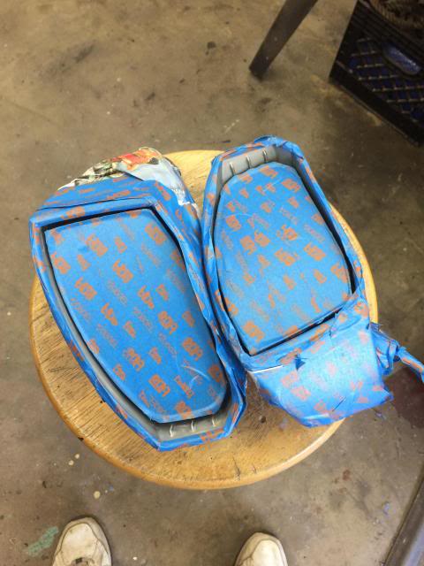

Dent and ding removal included the replacement door:
Down to bare metal. Dents and dings removed. Smoothed and painted. Clear coat and polish to follow. All told, there's probably ten spots around the car like this that needed varying degrees of attention. I'm no body man, but I'm proudest of the midline on that door....it was dinged in a few places. It was beat out from the inside, just a little filler skimmed on the surface:
And so on. Pulled the mirrors off, taped them up and shot paint around the inner edges up to where the wrap will meet. Decided against trying to remove the mirror glass after reading up on it:
Hoping to get it all done by the end of the month, so I can wait the 30 days the paint needs before I can wrap it.
