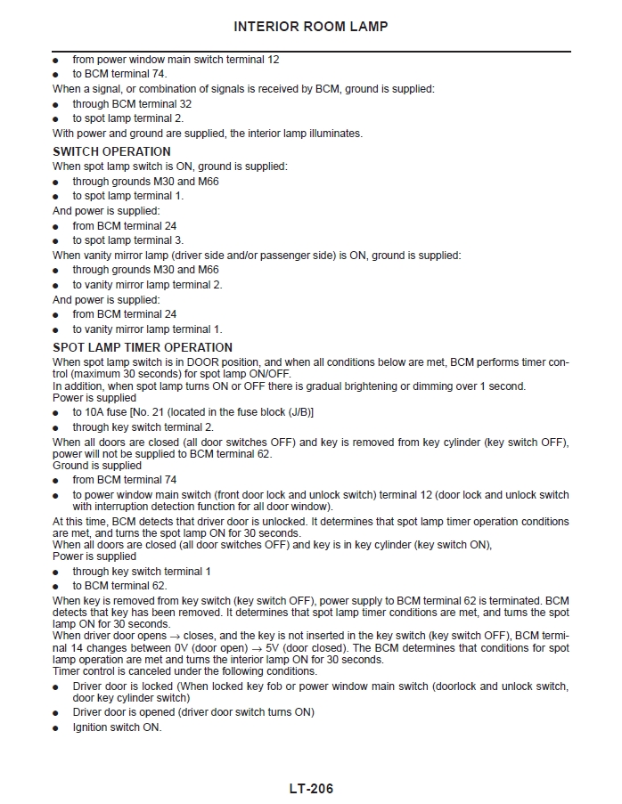

The below attachment was taken directly from the Factory Service Manual. It'll tell you what gets power when and how.
