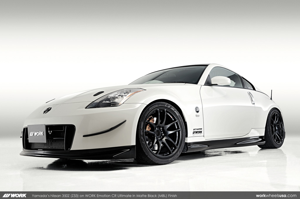

As the title says, I just want to make sure I know what to ask. Is there a certain type of paint? Any thing I need to get in writing?
I have been given a quote I am happy with. I am dropping the kit and car off tomorrow.
End result for this project is this picture

Great. Thanks for the replies. The body kit parts are fiberglass.
Suggestions on number of clear coats? Paint brand or type?
I will ask about the cutting and buffing. The quote was $1400 for install with two tone on the front bumper, rear bumper and side skirts. I expect it to go up a little as I am going to have him fill in the badge on the front bumper as well.
Base color is Pikes peak 3 stage and I am adding gloss black for the second color.
They do have a lifetime warranty on paint and work. I feel more confident since it is through the insurance company.

Correct, just the body kit. They have a lifetime warranty on paint and work as well.
I'll post pics when I get it back. Anyone know where I can find similar wheels gloss black? The ones in the pic are $450/piece which is too rich for my blood.
