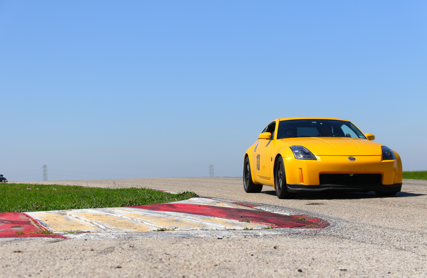

Every once and awhile I check in.. and update. Finally got my 350z to a full sized race track(have done autocross/shifter kart tracks). Two day course with an instructor both days and class time between each drive. We did 10 (twenty plus minute) sessions and my driving improved tremendously from where I began Saturday morning. Really a great experience! I spun the car off the track on the second day, but no damage was done as we just slid sideways across a grassy field. That was learning experience. In the years I have owned and run the car I had never had it surprise me like that. After some conversation and reflection I understand what went wrong. The car itself did very well. Nothing broke. I did have a heat issue with the oil temp that I had to manage. I would basically back off of driving it like I stole it and stick it in fifth on the long straights to try and keep the oil temps under control. They sat around the 240-245 degree range. The water temp was rock steady with no overheating there. I did some searching on this topic and did find there are others who have run the car at the track and hover around that same temp. I would prefer to see something around 225 degrees and as summer comes on this might get to be an issue. Speaking with my Z garage guy he is suggesting and water cooling system for the oil. I already have a setrab 34 row air cooler AND a deeper pan. At any rate, very happy with it. About to change ALL the fluids and see how the brake pads look this week. This really checked off a bucket list thing for me! Contemplating also the expense and wear and tear involved on the car and am I willing to commit to that. We will see.
