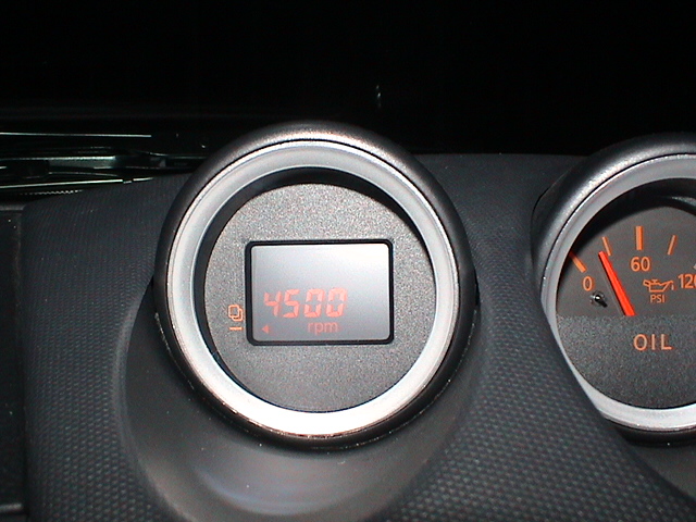

Default modified shift light...
got bored and did this..........
set rpm at 4500...

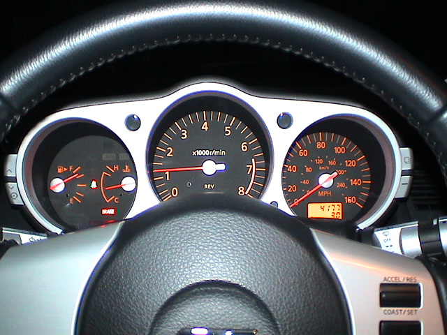

Default shift light
start engine........

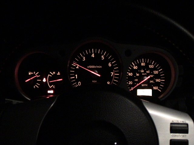

Default shift light
start rev'n.....

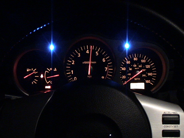

Default shift light
hits 4500rpm then..........

pics of LED : left and right on aluminum plate

Default shift light
kinda risky, but it works...open up the entire gauge/pod find trace on board lead to OEM shiftlight, tap/solder wire to 2 external bright LED. drill 2 holes on the aluminum plate, mount LEDs and reassemble.
