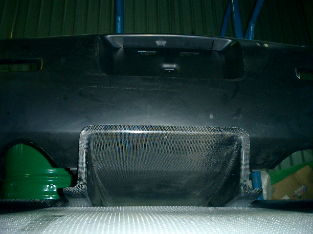

Those of you that are familiar with high end NSX parts have probably heard the name. Tiatec - they make JGTC parts (mainly this rear diffuser) for the NSX. I was wondering if anyone has seen anything like this for the 350Z. I have been looking for it FOREVER!!!
If anyone is interested in makeing one please PM me a price. Or any ideas on making one myself? please ideas, hints, coments?

i have one for the RSR gt2 (which will fit, i think the tanabe or one similar)... but the angle is pretty much flat if not like 1 or 2 degrees of incline.. not nearly as effective as stock exhaust.. but a work around since the back of my bumper is flapping as it catches wind with the stock exhaust now gone.. i just want to seal it off..
i've played around with ABS plastic, sheet metal, and carbon..
there are four mounting holes under the rear bumper where the stock muffler used to sit.. it holds the heat shield... i've built a truss that will come out like a spider to each corner of the diffuser, with an X brace... along with a rear bumper support to catch the back edge.. heat is the issue.. with my turbos, the exhaust is quite warm.....
the only issue with that Rx7 diffuser is that its not starting nearly soon enuf, nor high enough toward the rear axle for it to do any good.... but if there is a will.. there is a way..
