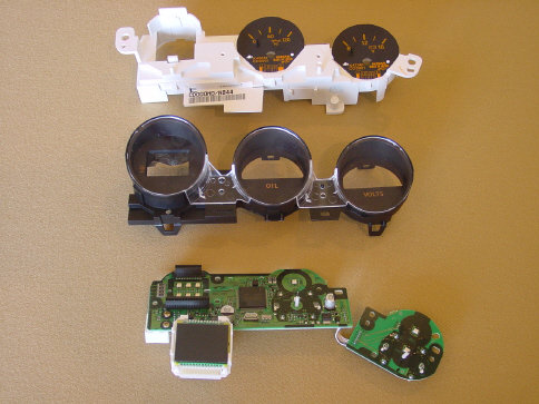

just ordered my 60mm guages and i wanna replace the oil and volts and then stick the other 3 on the a pillar, will my infometer still work if i take the other 2 out, also if not then how will my shift light work? also how do i get the factory guages out so i can put the others in?

The mulidata (infometer) display is the problem. Here's what you're up against.
Picture taken from autocarparts.com, where ACP has installed a defi-link gauge setup. Don't know what he did with the datadisplay.

Id suggest, you take the set out, based on ksheps photo, the screen appears to be seperate from the pcb by a cable or something. extend the cable and remotely mount that crap wherever itll fit, keeping the screen where it is.

Nah.. the LCD module is mounted via pins so it's easily removable.
Tim (ACP) says the needles take little effort to pull off.

if the LCD mounts via pins, how would you be able to relocate it? you would have to get each single pin and solder it to a wire and connect it respectively to the base (i.e. 5 pins = 5 wires?).

hmm interesting.......ill have to pull it all apart and see what happens, the guages will be here by friday so i will have pics up by saturday with the install. if there is a way to keep it ill figure it out and let you know whats up! thanks for all your help. i ordered 4 blitz guages boost egt oil pressure and water temp the blm series for only 375$ electronic.... if i have to mount the 3 in the stock place then do you think it would look stupid if i mounted the other one on the pillar with the aem wide band .... keep in mind the blitz is 60mm and the aem is 52mm so would it look stupid like that or should i not even care? i made the a pillar myself like the one on that thread about making your own pillar pod. also stillen exhaust is goin on and high flow cats, tomorrow.

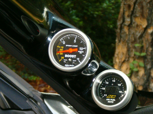

If you install the 60mm on the lower portion of the a-pillar and the 52mm above it...might be o-kay.

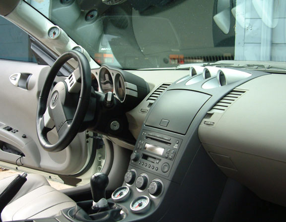

If you can't work those gauges into the OEM cluster, two can be installed underneath the A/C controls...but they might need to be 52mm

KShep in that pic what color name are those gauge inlays...silver or titanium?
Looks great.

Unfortunately, that's not my car with the gauge inlays, just a pic I had saved for those having trouble positioning gauges in the Z.
That is m3powrrr's work(a-pillar)...you can try pm'ing him with the thread id..maybe he can assist. Or e-mail sung@kbodyshop.com

Mine is the first a-pillar pic with the two gauge pods, black.
