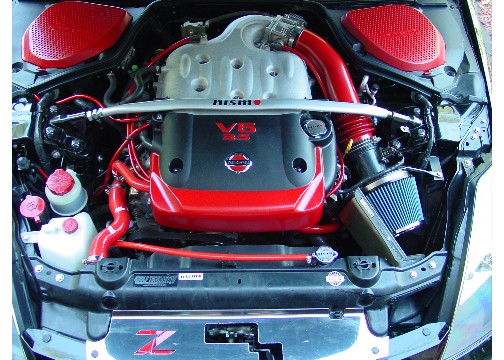

Have Rob "ZPRESENCE" do them. He does a fantastic job.
Old Oct 1, 2004 | 05:22 AM
KShep's Avatar
KShep
Posts: 1,385
From: Georgia
+1...his work is flawless.

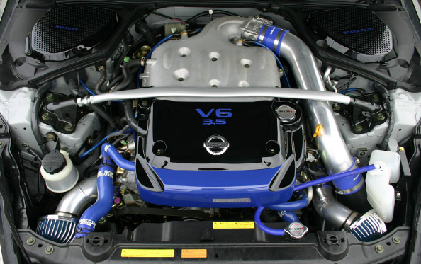

I used KRYLON "Fusion" spray paint.
Other than masking, I did no surface preparation. You shouldn't have to because of the flex in the plastic paint.
I put on two coats.
Total cost = $13.00
Time spent masking head cover = 1 hour
Attached Thumbnails quick questions on painting engine covers-total-engine-bay.jpg
Old Oct 1, 2004 | 06:32 AM
Bill d's Avatar
Bill d
Joined: Oct 2003
Posts: 285
From: Twin Cities, Minnesota
I put on two coats.
Total cost = $13.00
Another Pic:

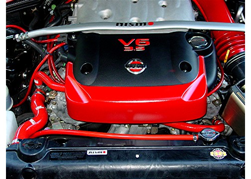

Just to give you an idea
my bay
