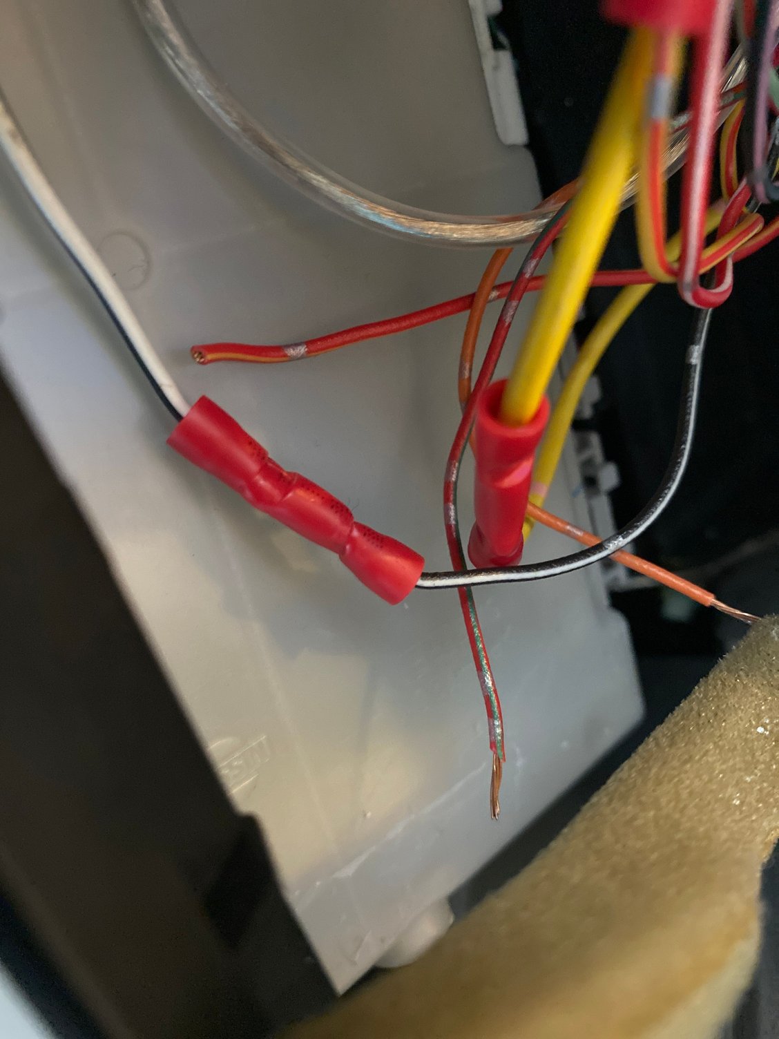

I own a 2006 enthusiast 350z. Somebody please help me understand even a possibility of why I have zero sound. I’ve connected the blue and white striped to 350zs green and white. I’m so stumped been confused for about 9 hours now
A possibility? Well, there are a lot of possibilities...
The blue/white striped wire from the head unit is the remote turn-on wire. The green/white wire in the Z is for the antenna amp which needs power for the radio to function properly, so that is correct.
However, you do realize that everything else needs to be connected properly, right? 12v+ constant, power, ACC power supply, ground, speakers, etc. etc.
Does the head unit power on? Is there audio from another source other than FM? Did you get a wiring harness to be plug n play, or did you try to wire everything up yourself? Is the cable connected from the Z's antenna to the antenna receptacle in the back of the head unit?

It is spliced into the factory harness but it was like that before I even got to it. So I took it a wire at a time and Just nothing. 12 volts read steady, all the speakers right.
What are these 3 wires seriously. No wire diagram shows what they are and I have everything connected

So the alpine just had zero audio output. **** was broke. So I put a new pioneer touch screen 120bt in. And now the ****ing rear speakers don’t make sound at all but the front do😐
