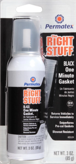

3. Chop out the bad Seal and replace it with RTV and Honda Gaskets (idk pretty cheap tho)
This almost seems too good to be true. Never found anyone that did the repair and actually followed up on how well the repair held up, so it just kinda seems sketchy to me. Would definitely do this if I could get some more support behind the fact that it will actually repair the problem and not just delay it.
