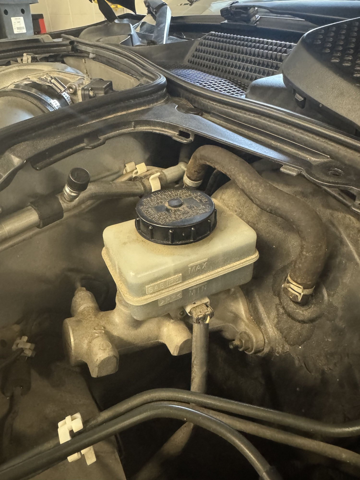

First step would be to pull the codes. Also, check the brake fluid. Sometimes if it's low, it will trigger those lights. Sounds relevant given the recent brake work. It could also be the camshaft/crankshaft position sensors. As I mentioned in the other thread where you posted, only replace with OEM. Aftermarket might work at first, but they will likely fail quickly. A bad crank/cam pos sensor won't always throw a code.

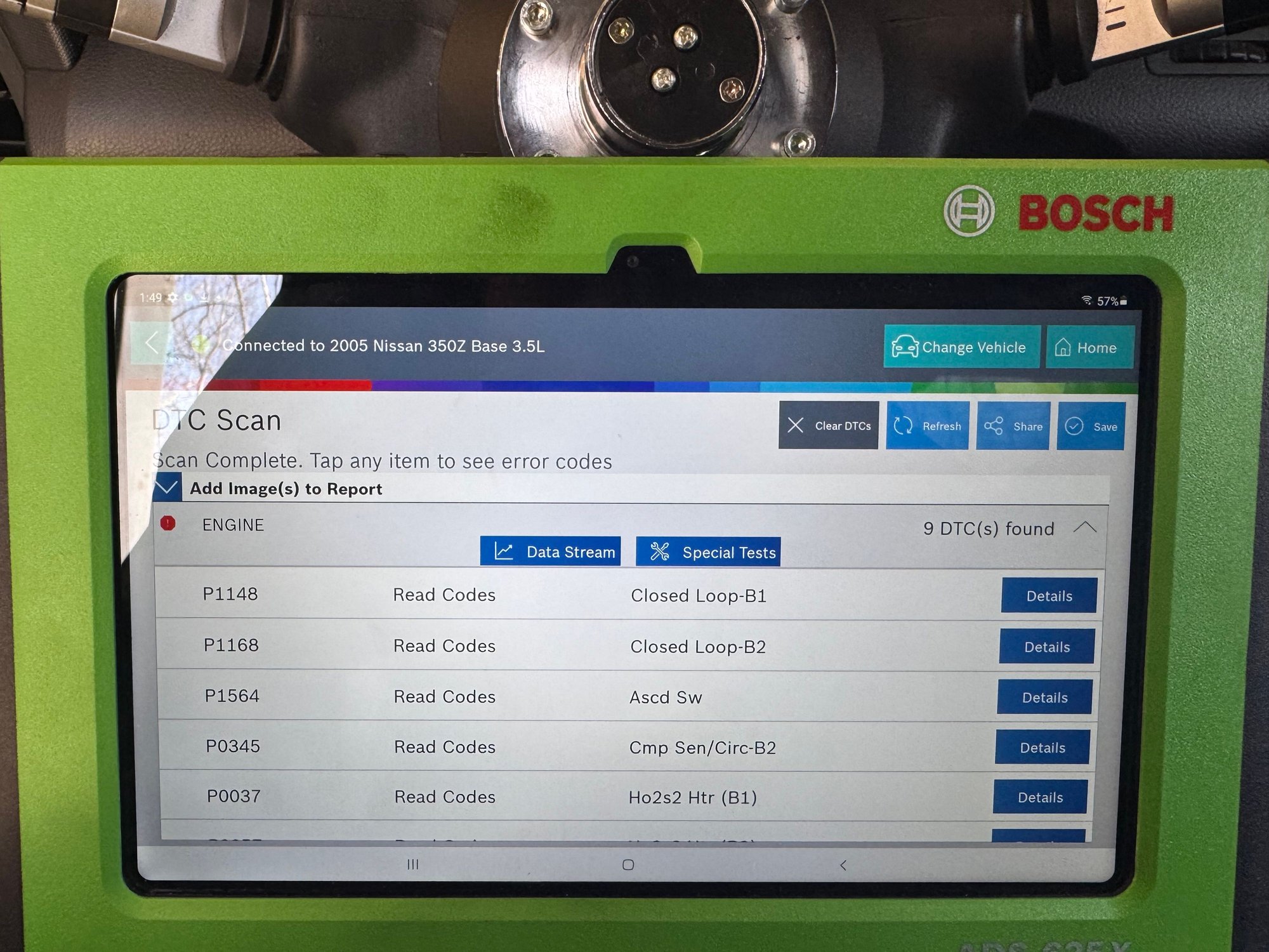

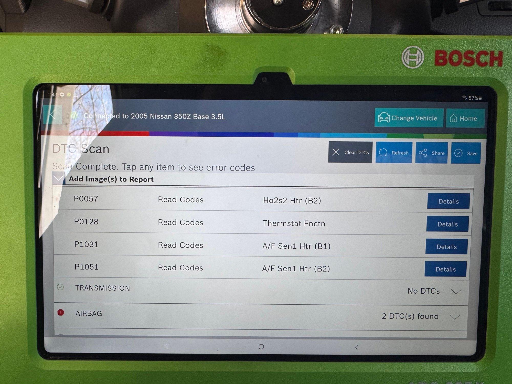

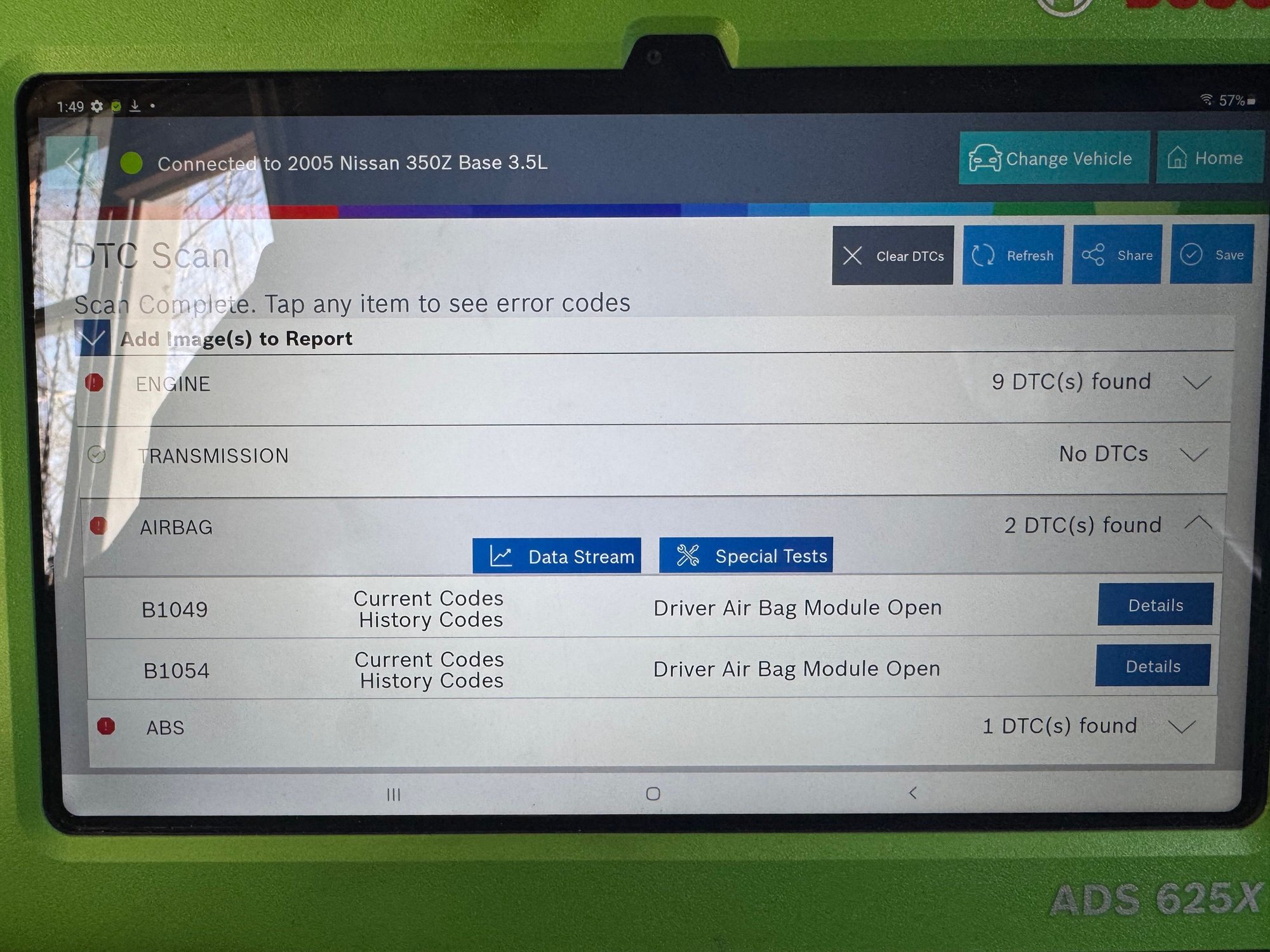

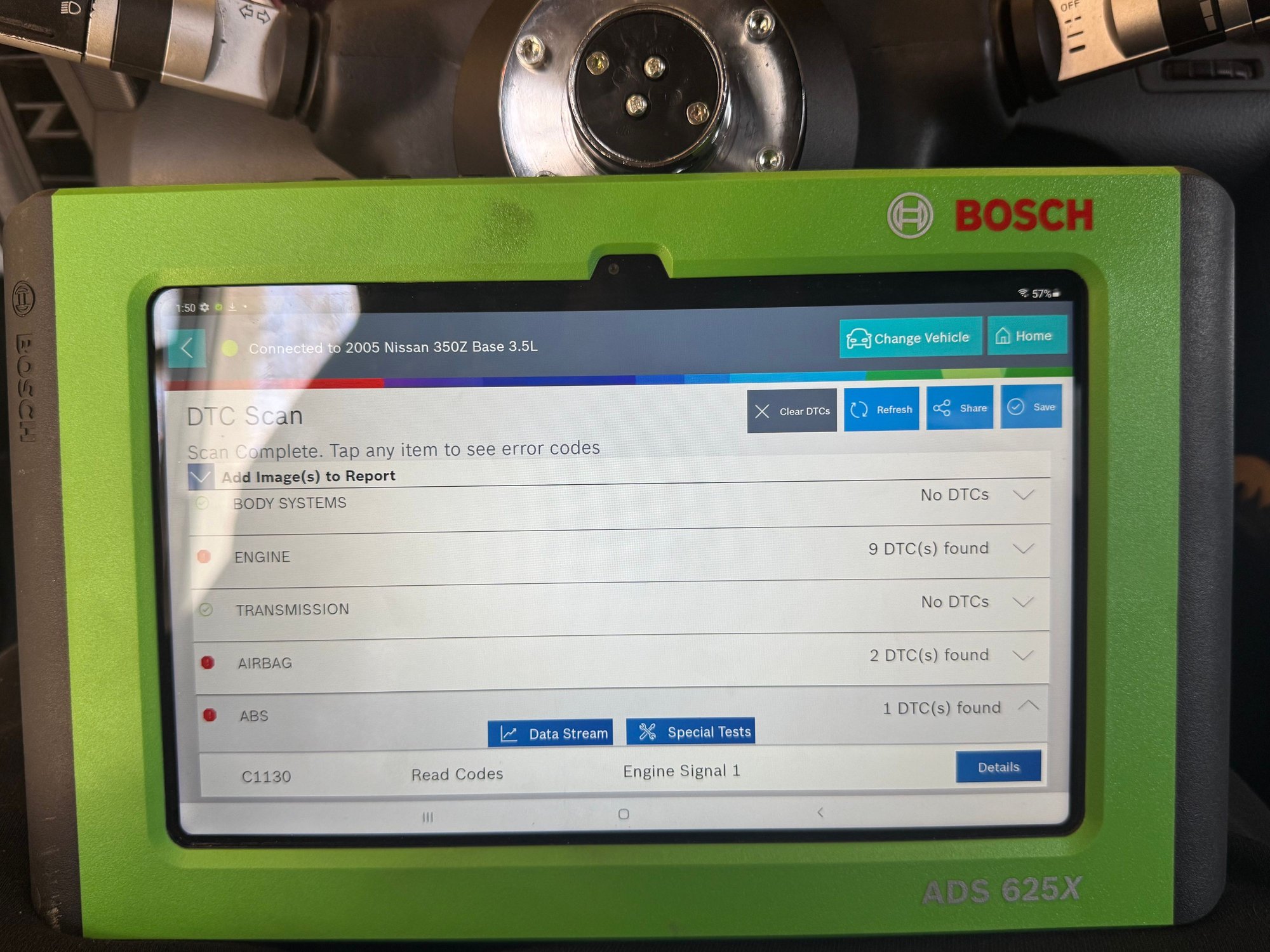

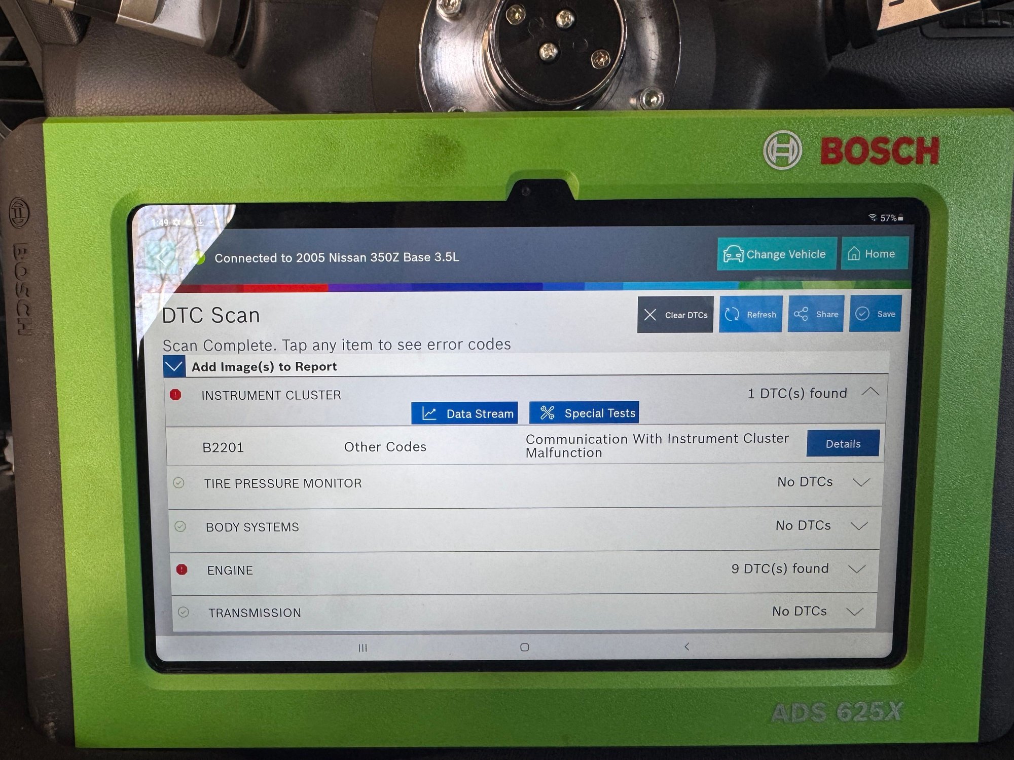

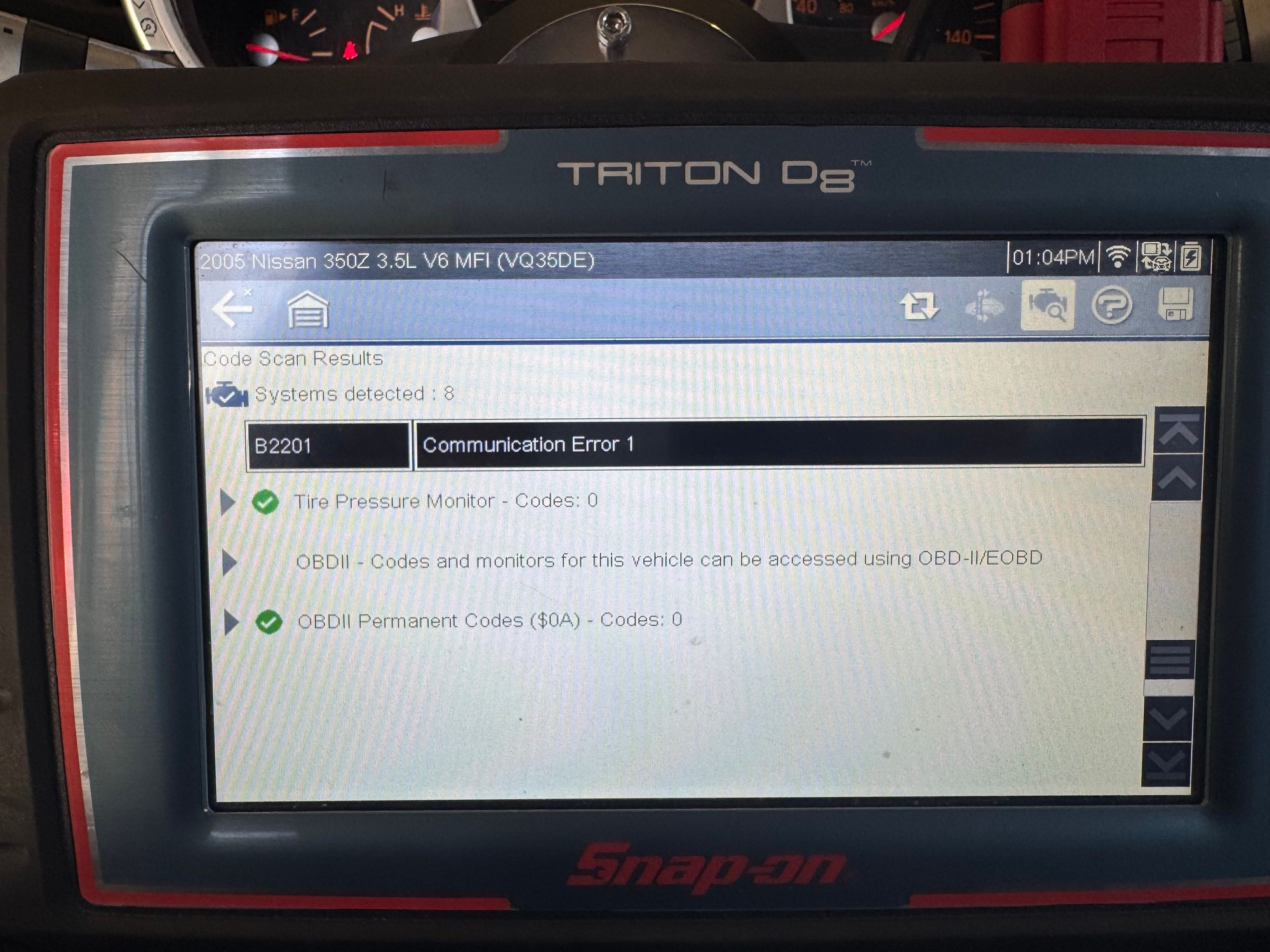

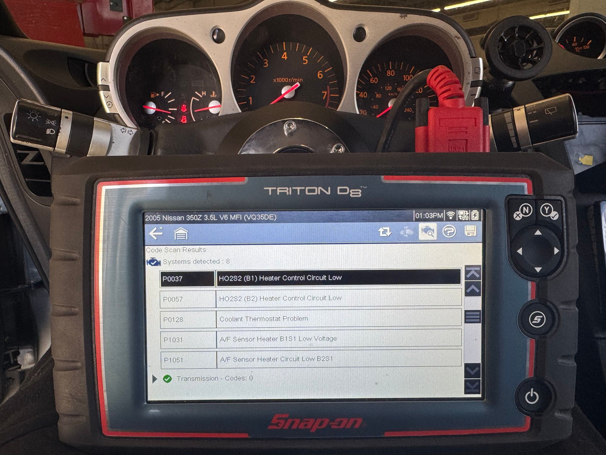

Alright people, here's what I got, I preformed a multi-scan using 2 different scanners, specifically BOSCH (ADS 625X) & Snap-On (TRITON D8).
Just for a heads up, car is a salvage title, airbags did deploy, creating 2 airbag driver module codes, and ASCD (steering wheel buttons, I installed a quick release about a month ago.); For some reason codes are visible for A/F after replacement, B1 Sensor 2 was fully cut through the wire harness most likely from past owners. The thermostat shows as problem, when I tried replacing it, the thermostat itself was removed from the housing, making coolant enter the engine 24/7, after new installation vehicle overheated, decided to install old one back again. This makes me more focused on the other 3 codes. My brake fluid is normal.
Both scanners read similar codes, they are the following: (Thanks for following up, let me know what you guys think, I'll replace CMP/CPS sensor with an OEM whenever I get paid.)
(B2201) - Communication W/ Instrument Cluster Malfunction/ Communication Error 1
(P1148) - Closed Loop B1
(P1168) - Closed Loop B2
(P1564) - ASCD
(P0345) - Camshaft Sensor Circuit/ Camshaft Position Sensor B2
(P0037) - A/F Sen.2 B1
(P0057) - A/F Sen.2 B2
(P0128) - Thermostat Problem
(P1031) - A/F Sen.1 B1
(P1051) - A/F Sen.1 B2
(B1049) - Driver Airbag Module
(B1054) - Driver Airbag Module
(C1130) - Engine Signal/ Fuel System Fault
Code is under
Code is under "METER" tab.
