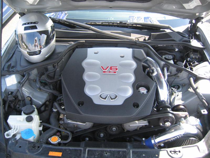

Ok, well I'll chime in. I went with the Vortech because I was happy with 400rwhp and if I decide to need more power, I'll build the motor and throw an APS TT in. A Procharger will never match the torque of a TT no matter how tunable they are. Plus, the Vortech is probably the most complete SC kit for the Z/G you'll find. Included everything you need. I have 9000 miles on my SC and it's running as strong as ever.
