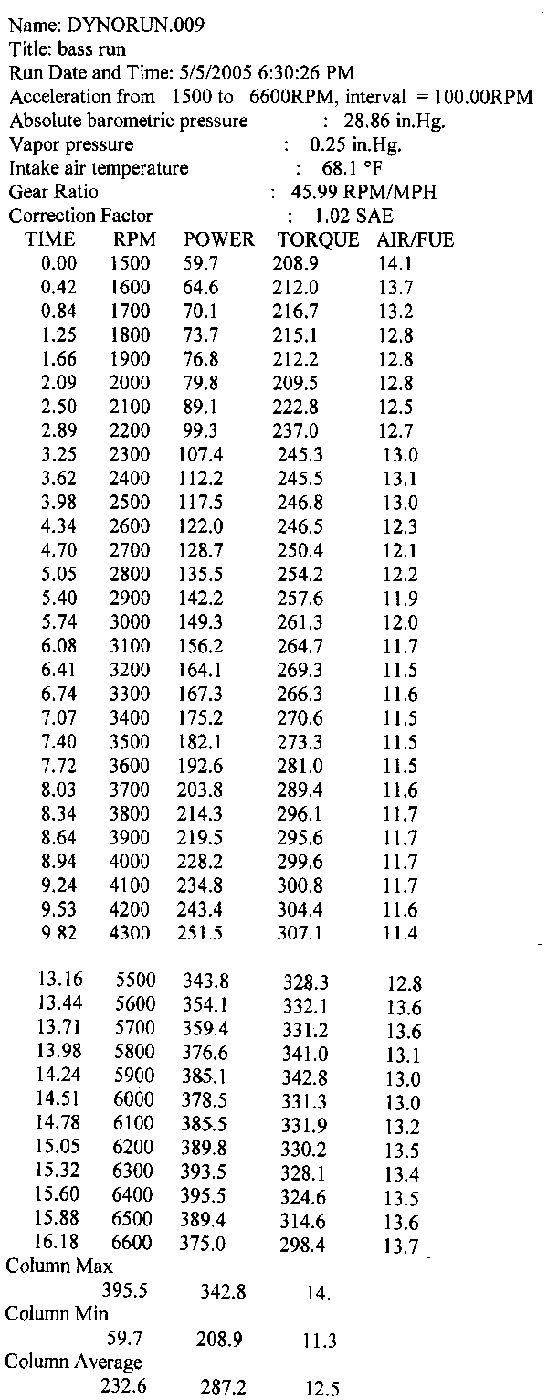

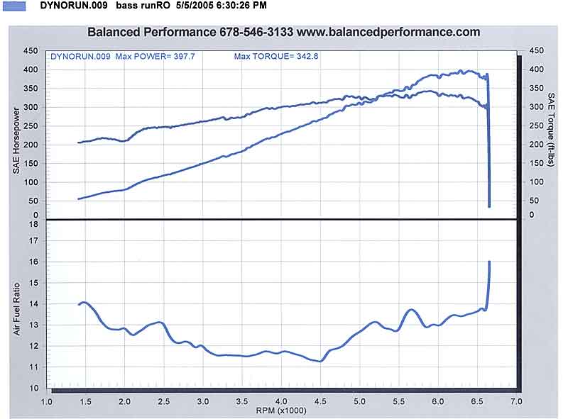

I have my car at the shop to get it tuned and they are having a problem. I wanted to get some feedback.
It seems that my car is intermittently going lean on the Dyno from run to run. My shop tracked down the problem and the fuel pump is not turning on. They checked all of the wiring, etc and even installed a manual switch to turn the fuel pump on and off and it is working. Apparently the split second box is not always sending a signal to the fuel pump to turn on. They have loaded the stock map and are still having the problem.
The shop has talked to the spilt-second who make the box and got some infromation about updating the aux fuel pump in the R4 software and I wanted to understand what the problem is so I have a few questions.
Has anybody else had any of these problems with the spilt-second box?
How do the settings in the R4 Software to control the aux fuel pump work? What are the stock settings? Do the settings change if I am tuning the car for more HP?
Thanks ahead of time for any answers to any of the questions above.
The shop has spent 2.5 hours on the dyno and about $125 dollars on researching the issue. They charge $150 an hour for dyno tuning. They are putting back on the dyno today probably for another 2 hours.
I want to understand if this is something they should have been aware of. That is why they get $150 an hour, right? If it turns out to be these settings shouldn't they have known that? If they put it back on for another 2 hours it will cost me $425 for them to change some settings. I expected to pay for 2-3 hours of dyno tuning, however I did not expect for them to not know about these settings. They have tuned multiple vortech 350z/G35. Paying the extra money does not sit well with me. Any ideas on how I should approach this?
Jeremy
Attached Thumbnails Vortech Help/Questions - Aux Fuel Pump not kicking in-dyno_vortech.jpg   Vortech Help/Questions - Aux Fuel Pump not kicking in-dyno_numbers.gif

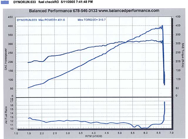

Well it seems updating the settings has worked and they were able to tune the car. They tuned it to 401 at the rear wheels and set the air fuel to be 10.8 over 6000 RPM. Nice and safe and plenty fast. I do not remember the torque however I will post the dynos tonight once i get the car back.
Jeremy

Here is the dyno:
Attached Thumbnails Vortech Help/Questions - Aux Fuel Pump not kicking in-dyno.jpg

Your chart is almost an overlay of mine.Where they differ is down low Below 3500rpm. Your Tq. #'s are slightly higher but your A/F is a little leaner here which would account for the delta..
Cool. I have the same headers, crawford cats and stillen exhaust with the stock plenum. I have the new Kinetix intake on order. So I take it you have your car runing rich at the top end as well for safety?
