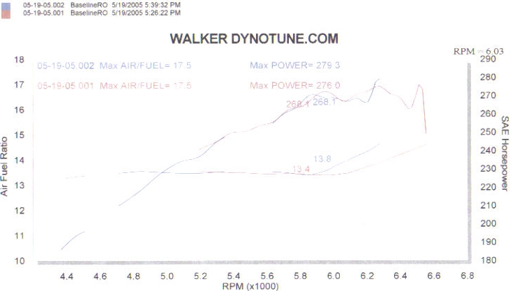

I went to the shop yesterday to watch the tuning of my car at the dyno it did not go well at all. First problem, I had Charles' (phunk) CAS wire installed and the car does not want to start. It will turn over for about 8-10 seconds before it starts. One time, I had to do this about 5 tmes for it to start. It will start, but it takes a while. At this time, it will throw a CEL and it is saying something about the crank angle sensor fault. You can clear the codes and it will not throw one again until you try to start the cra. Anyone have any ideas?
Next problem, my first dyno was around 275 HP!I know a lot of tuning is needed but thats ONLY 40 HP more than my NA setup. Also, the car is running horribly lean. It runs around 13.5 until around 6k RPMs and after that it spikes to around 16ish. Sounds like its on the verge of blowing to me. Next, the shop would try to add fuel, but the software wouldnt allow anything to be changed. It kept showing the RPMs at 500 and would not change from 500. I dont really know exactly what the deal is but they think its because of the CAS wire. Anyone got any good reasons on this?
So the car is back at the shop and they are going to be looking into the wiring of everything again including the CAS wire.

Its the R4 software. The shop thinks that maybe the CAS wire is what is causing the problems. I think they are going towire up the OEM one and see what happens. Not really sure though!

I had CAS wire problems as well with my installer. Also the lean condition is from loading maps - apparently the tuner has to change settings to turn the aux fuel pump on after loading a new map.
BTW - tuned the car rich over 6,000 RPM and now have 401. Could have gone more but better safe then sorry.
