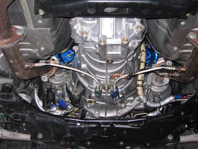

I got this picture off of phunk's website. This is his car. Since he knows his chit I would assume this is the right place for it.

If the intercooler touches the bar, put a piece of silicon hose in between. Even if it gently touches, the metal bumper brace will eventually eat through the aluminum intercooler.
In regards to the 02 bung. I would try to place it as far down the test pipe as possible, away from the hot exhuast gases. Wideband 02's dont like too much heat...so farther away from the turbo..the better.

too far away is not good either. 18" is probably just about right. I have run them just past the turbo before in some cars, over the years i have tried them in several places... so far ive got almost 20,000 miles on mine where it is, still reads dead on with my dynojet wideband which has been replaced like 30 times since i installed my in-car hks wideband. the dyno ones seem to die quickly if i use them as a tailpipe sniffer due to lack of heat and of course the dyno widebands see a lot of leaded fuel.
