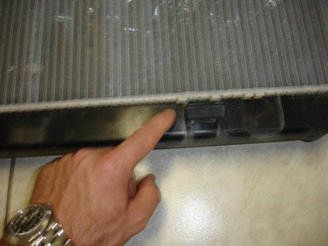

Keep an eye on that radiator and the fluids. My radiator was doing the same thing....It would be full and then all of a sudden it was almost empty, but when I filled it up and re-checked it later it would be fine. Turns out that it was leaking under pressure when I was boosting. I replaced it with a PE radiator and everything has been fine ever since.

Originally Posted by captj3
You can just replace the radiator cap to a 16lb cap stock is 13 somthing. I had the same problem tested and checked the system a number of times never found a problem until I changed the cap. Now the problem is fixed. The car never over heated. $10 fix at pepboys.
chit....cost me $700 for parts and labor...lol. I was going to change the radiator anyway.

I had never seen anyone post about the leaking under pressure, so I don't know if anyone else had the same problem with the stock radiator. Mine was leaking from the bottom. Here a picture of where it was leaking from. You can see the water stains.
As far as the koyo yes it does work with the greddy. do a search 350zDCalb recently posted pics of his intall and he has the greddy tt kit. Maybe try what captj3 said first and see how that works.
