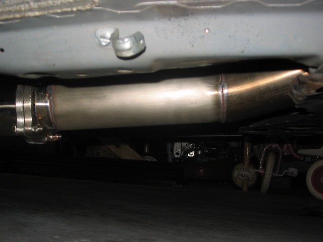

welcome to the mysterious world of APS, my car has never held boost until now. i finally had to wire my wastegate shut, now it hits and holds 10 psi till redline. i think the wastegate springs are weak.
about the exhaust, do what i did with my JIC, have somebody cut that reducer in half to where its 3", cut the flange off the JIC, and weld an extension in there with the larger end on the reducer on it so the JIC bolts right to the downpipe. simple.

here is a pic.

Originally Posted by tig488
here is a pic.
Thx for the pic, thats an excellent idea. BTW, are you running with or without the silencer on your exhaust? I cant stand how loud it is w/o the silencer in.

without the silencer.
