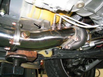

i am not 100% sure of this if the cause of the grinding noise, but when I went to check out the install on my car, i did notice that a stock bolt is literally 1 mm above the downpipe.
I had the shop grind off that bolt so I could get more clearance.
There are also a lot of stuff that has a very, very small clearacne with the frame of the car. This may be the cause of the rub. I hope to add my experience with the APS ST as well.

Talked to a buddy about the "grind" noise. He has the APS ST in his Z. The noise is common he says. Says it has to do with the knuckle on the steering shaft and also a very small clearance between the body and something else (forget what he said it was). Says they are fixable with a lil hard work. I'll post more when I can get an in depth explanation from him or he or someone else beats me to it and posts here. Drsifu, If I were you I would knock out that exhaust issue immediately while its in the shop and replace that reducer pipe with a 3 inch custom pipe.

I believe that was in the instuctions to grind that bolt down.
