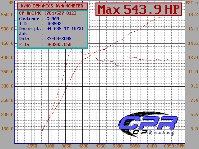

This is my car on 12.5psi with 8:8:1 compression. Disgregard the 10psi on the dyno chart.

PSI means nothing. Its air flow that matters. You can have a small turbo @ 20PSI and a larger one at 12PSI and the large one will make more power because it flows more air. But you are right about the compression.
exactly...on my supra i ran 21pnds on the stock twins probably making around 410rwhp....on my single at 18pnds ill probably make close to 525rwhp so on 3pnds less boost on a larger turbo im picking up over 100rwhp
