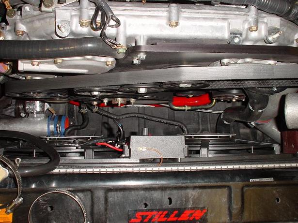

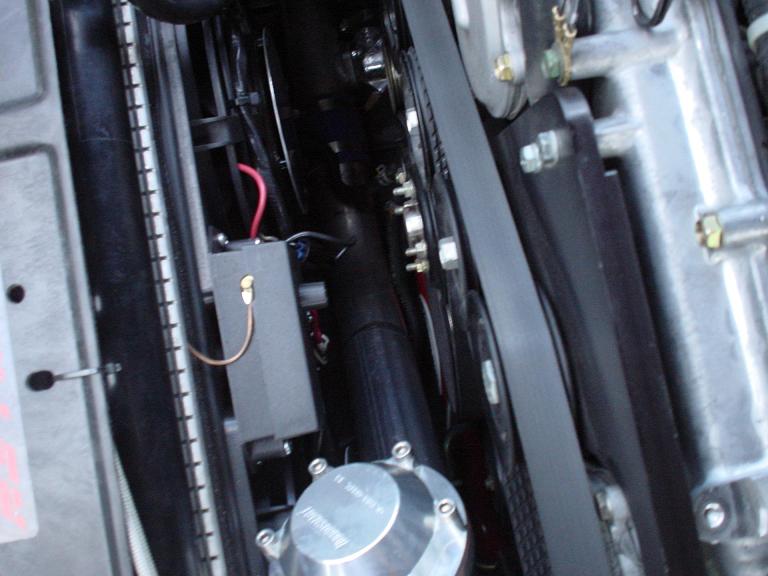

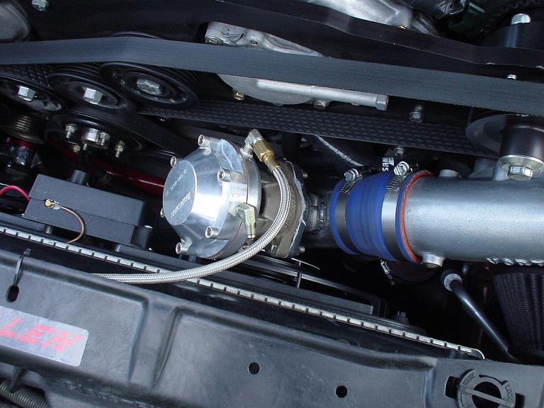

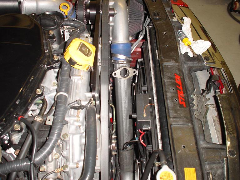

I was the one who did it. I'll post up some pictures of my setup. I had a custom "down" pipe made from the blower outlet to the BOV inlet pipe. This allowed me to bleed off boost with out tying up the IC. When I sold the setup the new owner had no room to mount the WG before the IC, so they mounted it in the 180 pipe just after the IC. I should also mention that I removed the factory fans and replaced the fans with a flex-a-lite thin fan setup. This gave me room for the WG. I tried to use a manual boost controller but it reacted too slow and cost my engine management to flake out. I removed the MBC and relied solely on the 8psi spring in the WG. This was the best way. I used an air compressor and simulated boost to diagnose all of this. The good news is using a 2.87 pulley w/WG allowed me to make 5-6psi at only 4500 rpms instead of at 5500 rpms. That means you're making more boost in the torque peak. My dyno was somewhat unique matching peak hp and tq numbers, instead of the usual 370ish hp and 300 tq. Mine was more like 350/350. Not to mention more streetable power. Best 1/4 time was 12.8 in a G sedan at5.
